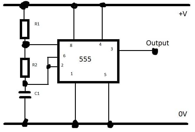

It's simple, I need a simple timer, that when powered on, will count down from a variable amount of seconds that are preferably shown on several 7 segmant displays, when the timer hits "0" the output goes high, simple as.
I figured I'd build it in 2 stages, the 555 timer to pulse every 1 second, then a counter of some sort (still yet to research that bit in depth) to store the timer pulses...
The help I need is this: I can't figure out the right values to get the 555 to pulse EVERY 1 second so make a perfect countdown timer. I tried using R1: 1K ohms R2: 7K ohms and C1: 100 nano farads. Gives me a time of "1.0394999999999999 seconds" which is close yes... but not close enough, and I know that resistors have discrepancies and what not, but I want it to be as close as possible, also. I remember something from college about the E32 series going up evenly... So is this the closest I can get?
Is there a chip that is set to exactly 1 second? Like a clock chip?
I also need a lot of help on a counter. Anyone know of a good link where I can look them up?
Please note this is for a home project.
T = 0.7 X (R1 + 2R2) X C1
This is my circuit diagram, drawn in MS Paint :D
555s are not really meant for use as high precision clocks, but you could get closer with a 10K multi-turn pot instead of your 7K resistor.
But you would need a much larger capacitor.
Don't forget the capacitance in that formula is in Farads.
I checked the frequency of your oscillator and it seems it should be oscillating at 960 Hz.

A better way would be to divide down from a crystal oscillator.
For example you could start with a 100 KHz crystal and divide by 10 to get 10 KHz then again to get 1 KHz with a 4518 chip then by 1000 with a 4059 chip to get exactly 1 Hz.
Or, because the 4059 chip is tricky, you could just use more 4518 chips to get to 1 Hz.
These 4518 chips are two divide-by-10 devices in one package so you can divide by 100 easily.

Great drawing. Pin 5 normally has a capacitor to ground, though.
