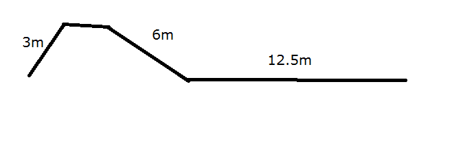

This is my terible drawing i made

So you drew the picture from the wording of the problem? What I questioned is if the flat portion is 12.5 meters or 6.5 meters. Is it clear in the original language?
The flat portion is 12.5m.
6.5m is from the diagonal line from the top of the hill to the flat area. Sorry for late answer, just took bus from library to home.

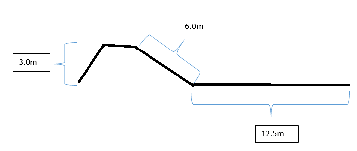

Maybe this drawing can clear some things up.
Thank you. There is enough information to reach a final numeric answer. So your final answer should be a number only (plus units).
So the basic problem is that you start out with all of the sled's energy being potential energy. The sled accelerates down the hill and all of that potential energy goes to one of two places - either converted to kinetic energy of the sled or is dissipated (Work). So at the bottom of the hill, the sled will only have kinetic energy. At the end of the flat portion, all of that kinetic energy will have been dissipated (Work) and the sled will have v = 0 m/s. So it looks like this is a problem where you have to solve both portions (hill and flat) simultaneously, because there is not enough information given to solve either part by itself.
Can you show some of your work - how to start the problem?
