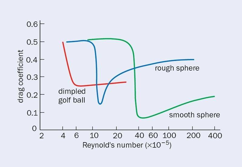

I seem to be getting Drag Coefficient Results similar to field measurements.
At least according to this image from http://physicsworld.com/cws/article/print/1998/jun/01/the-physics-of-football
Feel free to correct me if I miss understand.
