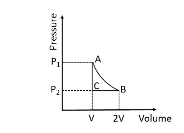

In the thermodynamic cycle shown, one mole of monoatomic ideal gas is taken through the cycle. AB is a reversible isothermal expansion at a temperature of 800K in which the volume of the gas is doubled. BC is an isobaric contraction to the original volume in which the temperature is reduced to 300K. CA is a constant volume process in which the pressure and temperature return to their initial values. Find the net amount of heat absorbed .
PV=RT
Q=C(T2-T1)
dU=dQ-dW
Cv=1.5R for monoatomic ideal gas
Cp = Cv+R = 2.5R
In AB, dU=0 (Isothermal)
Hence dQ=dW
W1= RT ln(2V/V) = RT ln(2) = 800R*ln(2)
Q1=W1 = 800R*ln(2)
Q2= Cp(300-800)=-500Cp = -500*2.5R
Q3 = Cv(800-300) = 500Cv = 500*1.5R
So Q= 800R*ln(2) -500*2.5R + 500*1.5R = 800R*ln(2) -500R
Hence net heat absorbed is 800R*ln(2) -500R

Suppose I find work done instead:
W1 = 800R*ln(2)
W2 = P2(ΔV) = P2*(V-2V)=-P2*V
W3=0
Now, P1V1=RT
P2V2 = RT
So, P2=P1/2=0.5P1
So,W2=-0.5*P1*V1=-0.5*R*T1 = -400R
So, Net work done is 800*R*ln(2) - 400R
As this is a cycle, dU=0 over it. And net heat absorbed is net work done. Hence
Net heat absorbed is 800*R*ln(2) - 400R
There is inconsistency here. What did I do wrong?
The 300 K is inconsistent with the pressure being half the original pressure at point C. It should be 400 K.
Likes Kaguro
:oops: I didn't notice that..
It's very annoying to have national level entrance exams having wrong questions. :mad:
Thanks very much for pointing it out.
