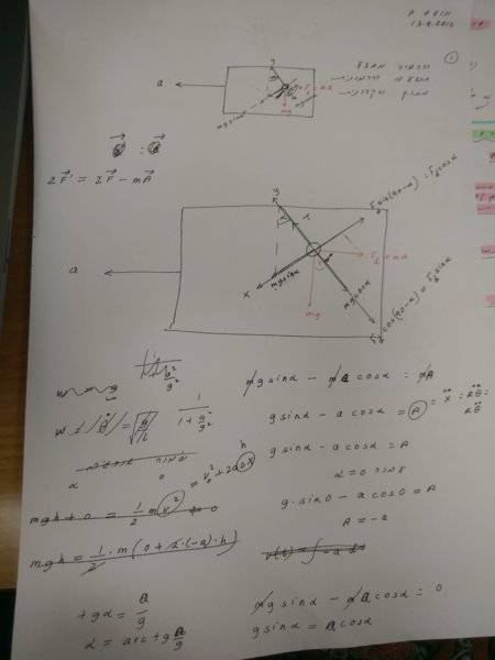

a car moving to the left with constent accelration. a ball is hanging from the ceiling held in 90 degrees to the ceiling until t=0, then it is realesed and start to swing.
find the max angle.
Newton's second law
gSin(α)-mCos(α)=A=R*(α'')
more detailed attempt

You need to type out the key steps and your answer. Your attached notes are unreadable.
thanks, fixed

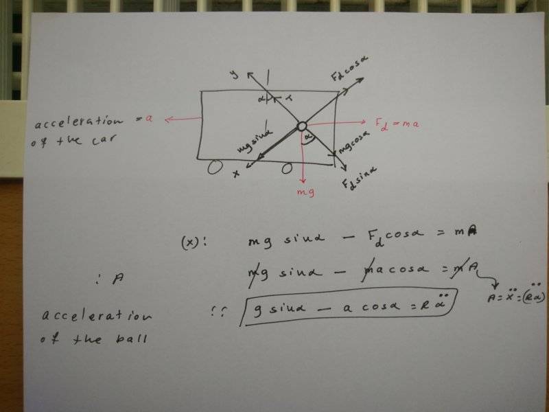

find the max angle.
Newton's second law
I think you have confused yourself with regard to angles. Please define exactly what your angle α represents. What is its relationship to the given θ?

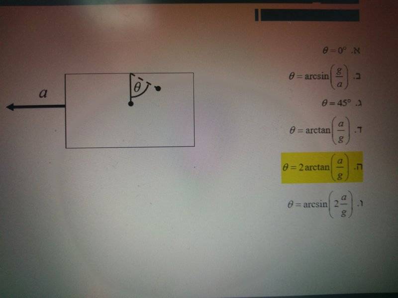

Is the right answer supposed to be the one highlighted in yellow?

That doesn't work. θ Is a given initial angle. You have a differential equation in which α is a variable.
You need to draw a diagram with the string at some intermediate position.
yes
Danielpom said:
yes
In that case, I would appreciate some clarification about what the question is actually asking, "find the max angle." I suppose that the original is not in English but in Hebrew, but could you provide as close a translation as possible as to what is asked for.
It's the maximum angle, not the equilibrium angle.
Likes DrClaude
the angle θ until the time t=0 is 0 (the object is held in its place), then, at t=0 the object is released and start to oscillate. the acceleration of the car it's all happening at is ' a '. the question is, what will the maximum angle θ be during its oscillation.
