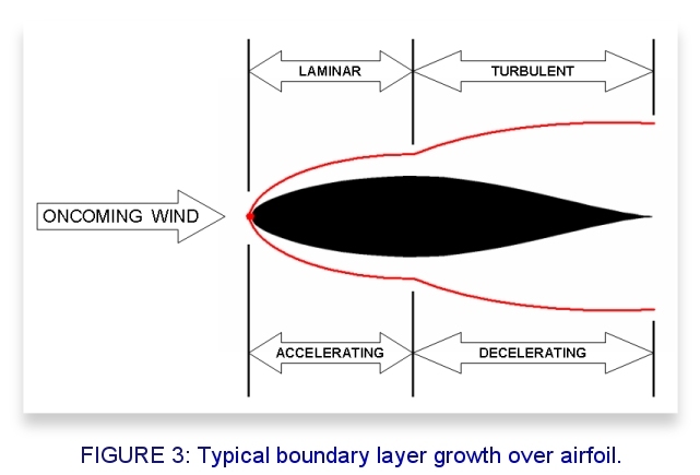

laminar airflow
A link to John Dreese's web site, parts 4 and 5 discuss how little air flow is laminar over many wings, and how "laminar" air foils increase laminar flow to 30% or more over the chord length of a wing.
In the case of gliders, laminar "bubbles" result in either more drag or less lift so the laminar air flow is deliberately broken up sooner than it normally would via rougher surfaces or turbulators (this is mentioned in the article).
http://www.dreesecode.com/primer/airfoil1.html
"The physical cause of low or high pressure is the forced normal (perpendicular) acceleration of streaming air caused by obstacles or curved planes in combination with the Coanda-effect.":
http://user.uni-frankfurt.de/~weltner/Mis6/mis6.html
This is true for lift related effects, but drag related pressures and accelerations are in the direction of travel, not perpendicular to it. As a simple example, a bus traveling down a highway, or a wing at zero effective angle of attack produce no lift, but generate drag, air is accelerated forwards, and the pressure behind the bus or wing is lower than the pressure in front of the bus or wing.
