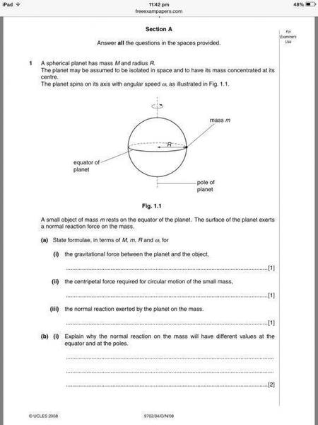

Why is the normal reaction of an object circulating a planet, equals to the gravitational force minus the centripetal force? I thought both gravitational force and centripetal force are directed towards the centre of the circular path i.e. in the same direction, therefore having, normal reaction = gravitational force + centripetal force. But instead, it's minus. Why?

Here it is :
Q1iii)

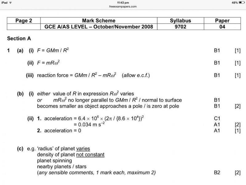

This is the answer :
Normal reaction = GMm/R^2 - mRω^2
I know that GMm/R^2 is the gravitational force between the planet and the object, and mRω^2 is the centripetal force required for the circular motion of the small mass, but why normal reaction exerted by the planet on the mass is the difference between the gravitational force and the centripetal force ? I thought gravitational force and centripetal force are both acting at the same direction , so both having the same sign. Instead one is negative and the other positive. So sorry for not showing an example at my earlier post, my bad. Thanks for the reply too

Doc Al said:
I assume you mean an object resting on the surface of a rotating planet.Newton's 2nd law: ΣF = ma
Since the acceleration is centripetal, we call the net force the "centripetal force". The only forces acting are the normal force (which acts outward) and the gravitational force (which acts centripetally). ("centripetal force" is not a separate force.) Taking the radially inward direction as positive: ΣF = Weight - Normal = m acentripetal.
Yeah , it's on the surface of the planet. And thanks so much, I got it now. But why is the centripetal force, the net force?
It's the other way around. For an object to move in circles, the net force must be equal to the centripetal force.
Don't think of "centripetal force" as a force. It's just the name we give to the net force in the case of centripetal acceleration. If you were asked to list all the forces acting on the object, you would not list "centripetal force" (or at least you'd better not!). Best to think in terms of ΣF = ma, where a = acentripetal.

I see, thanks. So centripetal force isn't a force that acts on the mass ? It's the resultant force of the two forces acting on it, the gravitational force and the normal reaction force ? Why is it a separate force?
Wow, I see I see. Thanks, it was clear. :)
Right.
It's not a separate force!
The only forces acting on the object (in your example) are the normal force and gravity. That's it!
Doc Al said:
Right.It's not a separate force!
Oh ok, understood. Thanks so much !
