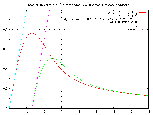

For now, I'd like to verify my derivation for the mean of a ratio of Gaussians. Attached to the bottom of this post is a graph showing (the red line) what my derivation produced as a final result. Also on the graph are 6 locations that I did numerical experiments on and received results in agreement with the derivation often. I don't think there is a question of whether the result is correct or not -- I'm confident it is correct; there is just more to the problem...
Notice, the graph has a numerator of N(1,0); a constant; but see the derivation itself to understand why it is sufficient for calculating mu of N(a,1) / N(b,1).
The formula I came up with is (drumroll please!):

What I have discovered.
  1. Change of variables naturally separates the numerator into a N(0,1), and a constant a.
  2. All division problems with std=1, can be reduced to computing 1/N(b,1) and scaling by a.
  3. There is a definite mean for every ratio of a and b
  4. Although the Cauchy distribution a=0,b=0 lies on a boundary that I don't believe is computed directly, none the less -- the limit of the solution clearly goes to zero at b=0 at very least, as the limit.
Comments? Questions? Suggestions? :cool:
