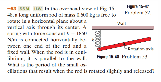

hello, i have some diffuculties with this problem, there's the point where the spring is attached to the rod and according to the equation of time period of physical pendulum , h represent the distance from the COM and the pivot point. here the pivot point is at the COM. and i know that it can't be (then the T would be infinity). i don't know if i need to calculate the T of the spring and it would be the same but than what part of the mass is attached to it.

It looks more like a spring-mass oscillation problem than a pendulum problem to me. Can you show us your FBD for the horizontal lever during small oscillations?

I think you need some specific analysis and an equation of motion for this problem.

you mean like this? it's an overhead view so the weight and normal cancel each other so there is only the kx of the spring.
