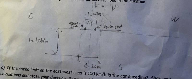

[Answer is V = 25m/s, however, how do I get that answer? Thank you!] A police cruiser sets up a novel radar speed trap, consisting of two transmitting antennas at the edge of a main north-south road. One antenna is 2.0 m [W] of the other. The antennas, essentially point sources of continuous radio waves, are fed from a common transmitter with a frequency of 9 3.0 10 ^9 Hz . The trap is set for cars traveling south. A motorist drive a car equipped with a “radar detector” along an east-west road that crosses the main road at a level intersection 100 m [N] of the radar trap. The motorist hears a series of beeps upon driving west through the intersection. The time interval between succesive quiet spots is 0.2s as the car crosses the main road. How fast is the car moving?
Unfortunately I cannot figure out a way to get V = 25 m/s, however that is the answer. It seems as though there are too many unknowns. Any help would be appreciated, thank you.

Hello sir. I've spent literally 4 hours trying to solve this.
Basically the given variables are
wavelength = ?
velocity = ?
delta x (nodal line distance) = ?
f = 3.0 * 10^9 Hz
d = 2.0 m
L = 1.0 * 10^2 m
t = 0.20 s
The equations that are relevant are
v = f * wavelength (universal wave equations)
delta x = t * v
delta x / L = wavelength /d
The beeps represent constructive interference and the quiet sports represent nodal lines (destructive interference).
I drew a diagram and know from the question that delta x (distance) is 0.2 s. So if I knew the velocity then I could get delta x. Hence the reason why I wrote the equation.
To approach the question what I did was to actually make system of equations but then noticed that the unknown variables just cancel out on each other and cannot be solved.
The system of equations will be three unknowns with two unknowns on each. However since there is no addition and it's just a pure relationship it is holding me back.
I drew a diagram
Are you sure that the problem statement is exactly as it was give to you? No typos?
At 93 GHz frequency I'd think that the fringe spacing would be pretty short, less than a meter anyways at 100 m distance from the sources. If the correct answer is v = 25 m/s, then with a Δt between quiet zones of 0.2 s, the distance between the zones should be
##\Delta x = v \Delta t = 5 m##.
I don't see how to get that with the given values.
Although the distance between the sources is not terribly much smaller than the distance to the car, a rough approximation of the distance between fringes can be found as
##\Delta x \approx D \frac{\lambda}{d}## which gives ##\Delta x \approx 0.161\;m##.

From your original post:
C F said:
...are fed from a common transmitter with a frequency of 9 3.0 10 ^9 Hz .
I assumed that the space between the 9 and 3 was a typo. That's why I asked about the problem statement being a faithful rendition of the original. The wavelength then became:
##\lambda = \frac{c}{f}##
This new information makes a lot of difference! Now we find:
##\Delta x \approx D \frac{\lambda}{d}## so that ##\Delta x \approx 4.997\;m## or near enough to 5 m as expected from the given answer.
