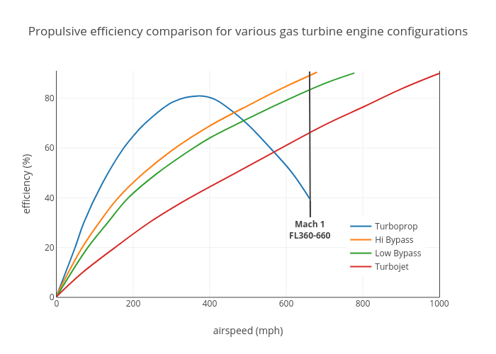

I believe that these efficiency versus speed relationships apply to model airplanes as well as full scale airplanes. For realistic speeds, an electric powered model plane is most efficient with a propeller.
Photo is the work of https://commons.wikimedia.org/wiki/User:Marc_Lacoste
