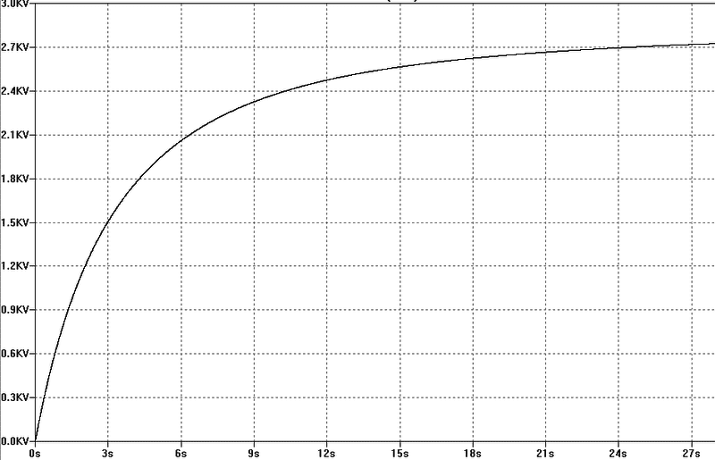

This graph is for 1000 ohms series resistance and 2000 uF but 60 Hz input frequency. I tried 50 Hz and it didn't make any difference.

Any idea on what relation this has with the charging power?
I can't relate these two things together.
Let's say i measure the secondary resistance and get a calculated answer close to what i see in practical. The charging of the bank completes 2000Vdc within 6 secs. I did the test many times to make sure of it.
Manufacturer states it charges 600Joules per sec, is it equal to 600W?
Bank = 4000J
So calculations show ~5 secs.
The stepup transformer has a power of 230V x 16A = 3680VA
Effective power = 3680 x Power Factor = 600W
That is a very low power factor is my equations are correct.
Am i missing something?
600 joules / second is the same as 600 watts.
However, you can't take the rating of the transformer and say this is the current being used.
The actual current decreases as the capacitor charges up. My simulation shows it as starting at 2.8 amps and dropping to about 0.7 amps at the 6 second point. These are peak values.
Eventually, the current would drop to zero.
The capacitor has 4 coulombs of charge in it. (2000 V * 0.002 Farads). (Q = C * V)
So the average current to charge it was 4 coulombs / 6 seconds = 0.666 amps (Q = I * t)
So loss in 1000 ohms series resistor = I * I * R = .66 * .66 * 1000 = 443 watts or 443 joules / second.
Charge in capacitor = 0.5 * V * V * C = 0.5 * 2000 V * 2000 V * 0.002 F = 4000 joules
Charging rate = 4000 joules / 6 seconds = 666.6 joules / sec
Efficiency = (666.6 / 666.66 + 443) *100 = (666.6 / 1109.6) *100 = 60 %
Wow . . . . that's the BIG difference between just "knowing" and "knowing how to apply what u learnt"
