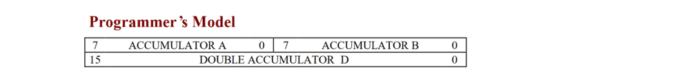

With reference to the block diagram of the CPU, although the data busses have a width of 8-bits most of the instructions have 16-bit equivalent instructions.
The C68MX11 offers multiply, add, subtract, compare, increment and decrement, load & store, and shift instructions of 16-bit operands.
The CPU consists of 8-bit accumulators used to hold operands and results of arithmetic calculations or data manipulations.
The accumulator A and B can be combined into a 16-bit double accumulator D that can store these 16-bit equivalent instructions.

ACC.A and ACC.B are accumulators.
Accumulator A is the most significant octet while Accumulator B is the least significant octet.
The contents of these two 8-bit accumulators are fed into the ALU and then via the CCR are stored in Accumulator D.

ACC.A and ACC.B are accumulators: accumulator A and accumulator B respectively.
These two general-purpose 8-bit accumulators are used to store operands and results of arithmetic calculations or data manipulations and then fed to the next immediate level, i.e. the contents of these two 8-bit accumulators are fed into the 16-bit ALU.

    I don't see where A & B go thru the CCR to get to the ALU, it seems to be a direct route; {register}-->ALU. The main purpose of CCR is to hold flag bits that reflect ALU results, so things like the Carry out of an operation can be used as input to the next ALU instruction, or to test if a Conditional Branch instruction should be taken or not.
  • Or A and B (which comprise D)
    This wording seems to imply that D is a way of treating the A and B registers as a single item. I reality, D is another register that is separate from A and B.
Likes Michael Neo
This wording seems to imply that D isa way of treating the A and B registsrs as a single item. In reality, D is another register that is separate from A and B.
The confusion stems from the wording of the data sheet:
The CPU consists of two general-purpose 8-bit accumulators used to hold operands and results of arithmetic calculations or data manipulations. The accumulator A and B can be combined into a 16 bit double accumulator D.
So, this actually means the contents of A and B can be placed into D?

The accumulators A, B and D
In the data sheet, it states:
“Although the data busses have a width of 8 bit most of the instructions have 16 bit equivalent instructions. The C68MX11 offers multiply, add, subtract, compare, increment & decrement, load & store, and shift instructions of 16 bit operands. The CPU consists of two general-purpose 8-bit accumulators used to hold operands and results of arithmetic calculations or data manipulations. The accumulator A and B can be combined into a 16 bit double accumulator D.”
An accumulator is a register for short-term storage of operands, and results of arithmetic calculations or data manipulations.
Accumulator A and B are 8-bit while accumulator D is 16-bit.
However, most of the instructions have 16-bit equivalent instructions but the data busses have a width of 8-bits.
The contents of the 8-bit accumulators A and B can, after manipulation, be stored in 16-bit double accumulator D; after, for example, information from A and B is taken to the 16-bit ALU.

The confusion was mine. I misread the data sheet block diagram. The A and B can combine to form the D register. Sorry.:sorry:
Michael Neo said:
So, the CCR is not involved at all!
Yup, it just holds the status of the most recent ALU operation.
Michael Neo said:
How is the output of the ALU directed to ACC.D?
If there are 16-bit arithmatic instructions, the ALU result must go to both A and B registers. Then 16-bit Store insructions could write the D register (A and B combined) to memory.
