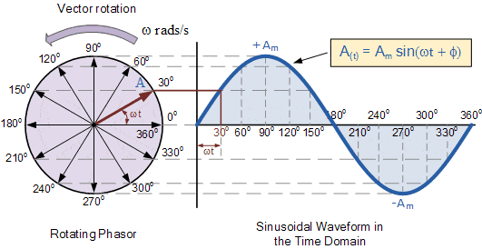

One's first instructor should take one through this diagram:
which paints in one's mind the relation between a wire loop rotating in a magnetic field and the voltage that results
and how natural is the relation between time and angle.

indeed i woke up last night realizing my wire loop analogy is likely off a quarter turn from the image i picked...
You guys over there don't have Whitworth phasors or something , do you ?
Ahhhh now think i see what you mean - the diagram i picked shows ωt pointing to a phasor labelled 30° not π/6 radians.
Yet ω is defined at top as radians/sec...
One must decide at start of every exercise what units he'll use, degrees or radians.
Rigor is the price of preciseness in understanding?
Thank heaven for Pi !old jim
