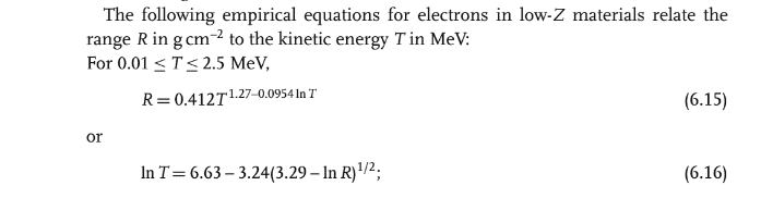

Range when 0< T <= 2.5 MeV: R= .412+T^[1.27-.0954*ln(T)] where T is kinetic energy of beta particle
also ln(T)= 6.63-3.24[3.29-ln(R)]^.5

Also that second relationship is given to me. See image.

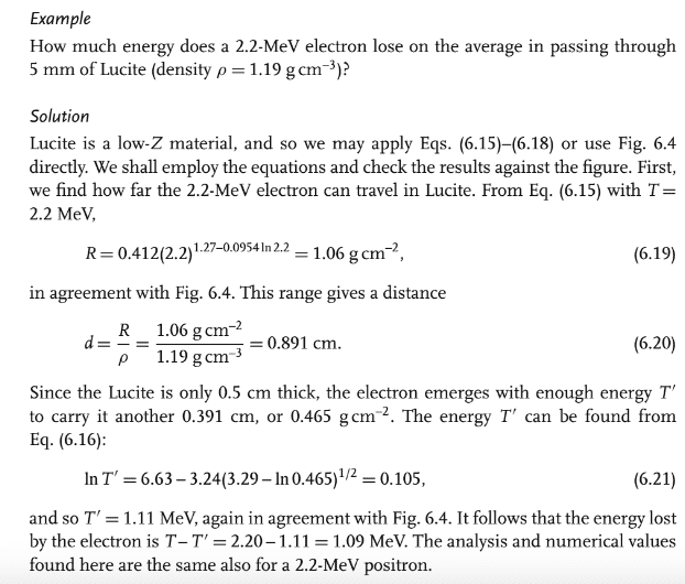

The assumption we are making in this problem is that the electron will travel in a straight line through the medium. I know this isn't true at all but for the purposes of this problem that is what they want us to do. Therefore with that assumption we can use the range of the beta particle to give us an approximation how far the particle will travel. I attached an example of a similar type of calculation from the book as well.

Binder12345 said:
I may be starting to convince myself 2.2 from the back of the book is actually wrong
I suspect that you're right.
Why don't you try plugging 2.2 MeV as the starting energy and work the example you posted above in exactly the same way that they did (using your density and thickness of course) and see if you can arrive at a 1.62 MeV positron exiting the slab?

OK, I find this terminology strange but I accept that this "length" terminology is used for the parameter R which is related to the number of encounters the particle experiences while passing through the material, and that this length (that reference calls it "interaction depth") is in units of mass/length^2.
http://cosmic.lbl.gov/SKliewer/Cosmic_Rays/Interaction.htm
There are other things I find strange about the terminology in your example, but I'll let it go. I agree with the suggestion to start with a 2.2 MeV particle and see what energy you end up with, using exactly the same calculations.
Your analysis given the additional information seems correct. Since R is proportional to path, it is additive.
