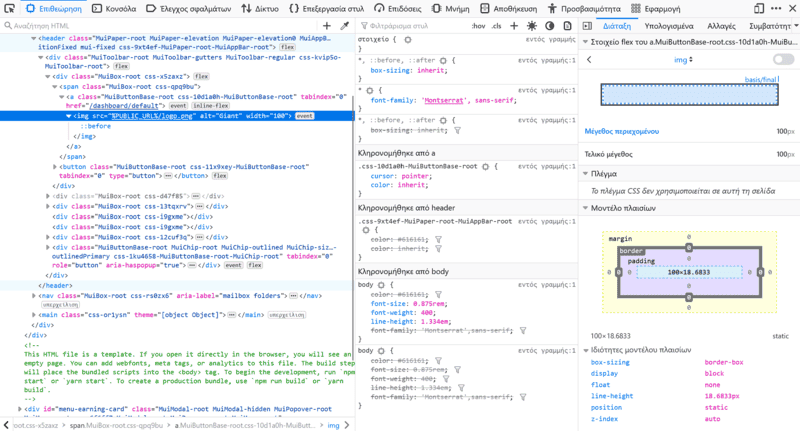

When I right click in the browser it says that the loading of the image is not possible. What am I doing wrong? 🤔
It should be possible to right click and select inspect element. That should show a list of tab sheets and one of them shows the elements. We should see more information there. In particular we want to know from which path it tried to load the image.

We have the following:
When I click on "event" we see :
It shows that it expects the image at %PUBLIC_URL%/logo.png, which is not a valid path. The %PUBLIC_URL% is not expanded. It should have been replaced on the server side somehow. You might try to just leave it out completely, or otherwise replace it by a path to where the image actually is.
Likes mathmari
There is no server side (unless you are building for Next.js). %PUBLIC_URL% should be replaced in the build stage by create react app, although you often don't need it at all.

At the Inspect I get :
What does that mean? 🤔
The text {logo} has not been expanded. I'm not sure why. Which command did you use to build and run the web application? 🤔
Suppose you add console.log(logo) after line 2 as shown in the example that @pbuk pointed out. What do you get in the logging then? You can see the logging if you right click, select Inspect, and select the Console tab sheet. 🤔
You might try to replace {logo} in line 8 by logo.png, or perhaps /assets/img/logo.png to see if the image will show up then. 🤔
