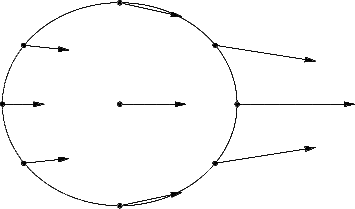

He explains it very well via the gravity gradient, but at the and he also mentions the "centrifugal force", as an alternative explanation. Today we understand the "inertial centrifugal force" as a force acting radially in reference frames which axes are rotating. If you just attach the reference frame to the Earths center, but keep the axes orientation constant, you don't have a "inertial centrifugal force" in that frame, just a "inertial uniform force", parallel to the Moon-Earth axis. This the same "inertial uniform force" that is added to the gravity vectors between these two pictures:
Inertial frame, where only gravity exists:
Linearly accelerated restframe of the center, where a uniform inertial force is added to gravity:
Personally I don't think that invoking that inertial force is a good explanation for the deformation: It is a uniform force so it cannot defom anything.
Of course you can use frames that are actually rotating and have an "inertial centrifugal force". But even in those frames that centrifugal force cannot be blamed for the two bulges. It can partially explain the equatorial bulge in those frames, if the Earth is spinning in the inertial frame. Otherwise it is canceled by the inertial Coriollis force. See:
Why not? You used that inertial force yourself in those images, and in your words!
That inertial force is, to me, the easiest way to explain the tides. One way to explain the tides is to express the tidal forces in an Earth-centered frame of reference. That's an accelerating reference frame. With this explanation, the tides result from the Moon's non-uniform gravitational field (gravity gradient) and from the acceleration of the Earth as a whole toward the Moon (inertial force). That is exactly what your two images depict. You can explain the tidal bulge from the perspective of any frame of reference. All frames of reference are equally valid after all. However, it is not easy to do this correctly from the perspective of an Earth-Moon barycenter frame, rotating or non-rotating. The explanations that rely on centrifugal force are the canonical example of how to do it incorrectly. That these explanations get the right answer is due to a combination of errors that cancel one another out. Just because two wrongs get the right answer does not mean that it is right.
D H said:
Why not?
To clarify what I meant: "invoking that inertial force as a reason for the deformation is not good". Because as I said: A uniform force field cannot deform anything.
My explanation in words actually uses no inertial forces, just the differential gravity: The Moon's gravity pulls the Earth's center stronger than the Earth's opposite side. So the Earth's center is pulled away from the Earth's opposite side. To me the first picture already shows that the center and the opposite side are being pulled apart.
Going into the center's frame (second picture) maybe makes it more obvious visually, but it is still solely the gravity gradient that "causes" deformation, not the uniform inertial force field. Using the inertial force in an explanation is okay, but not as a cause of deformation.
Yes, but since the gravity gradient explains the tidal deformation completely in the inertial frame, it also explains it completely in all other frames (the gravity gradient and the tidal deformation are the same in all frames). So whatever inertial forces you introduce through the choice of the frame, their net effect on the tidal deformation is zero.
