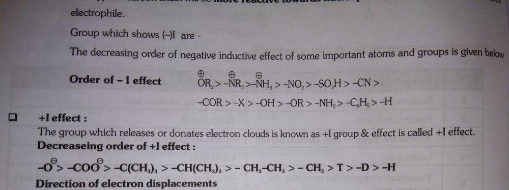

I have been given order of - I effect of different groups. But I don't know why these groups follow these order.
I effect is directly proportional to the electron affinity of the group
Here it has been given that NR3+ has more - I effect than NH3+ but according to my knowledge R group has more +I effect that H. So NR3+ will be stabilised by R groups' +I effect and hence NH3+ should have more - I effect.
+I effect is positive inductive effect and - I effect is negative inductive effect
Can someone please answer me

Where? The inductive effect manifests itself in a few different places (acidity, regioselectivity, etc.). Different applications sometimes give different results. At any rate, I doubt that the inductive effects from NH3 and NR3 really differ substantially.

This order has been given in my textbook
of organic chemistry

I don’t know what organic chemistry book you’re using, but I’ve noticed in some organic chemistry books a tendency to overapply a loose rule of thumb. In this case, my general point was that the inductive effects from NR3 and NH3 likely won’t be very different in practice; moreover, they’re likely to be swamped by other, more relevant, considerations in most situations.

No, the trialkylammonium group (-NR3+) is more electron withdrawing than the ammonium group (-NH3+) due to steric effects. Those bulky alkyl groups try harder to achieve a planar structure which makes the bond attached to, whatever, have more ‘p’ character... a shorter bond closer to the positively-charged nitrogen. And closer to the fire usually means warmer!

The alkyl groups are big enough to bump into each other. They try to get away from each other. The only way to space out is to move more towards a planar structure (they don’t actually achieve planarity). The bond angles (R-N-R) get a little larger. One way to think of it is that the hybridization of the attached N bond changes slightly from sp3 to sp2.?.
Kind of like a VSEPR approach coupled with a bit of quantum mechanics.

Wouldn't they get more space in a 3 d structure than a 2d planar structure. How come hybridisation of the molecule change it depends on the no if atoms attached to the central atom which doesn't vary in this case.
Review Bent’s rule.
