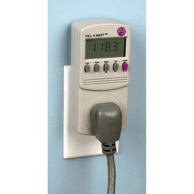

If the voltage is AC, you should use a standard power monitoring module. Something along the lines of a Kill-A-Watt module, but a little higher power capability and with the appropriate interface for your processor.
https://www.harborfreight.com/kill-a-watt-electric-monitor-93519.html
