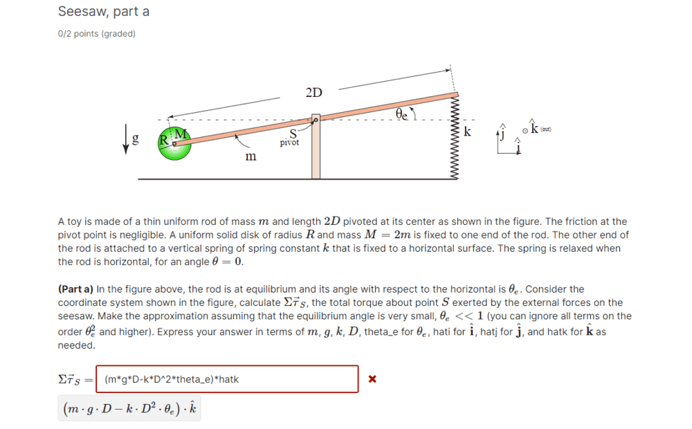

The question ask to find torque about the pivot point S.
I first find the torque due to gravity of the plate and then torque due to spring force.
I understand that the weight of the rod do no torque as it is acting on the pivot S.
Where have I gone wrong?
You used ##m## instead of ##M = 2m## for the mass of the disk.
thank you so much
