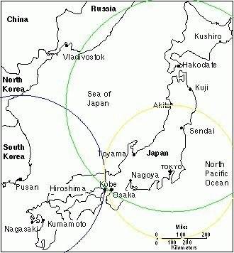

Location is done by triangulation using a minimum of 3 sensors spread well apart and not in a line with each other. The more sensors you have recording the quake, the more accurate you can get the location of the quake.
here's an example of a triangulation of the Kobe, Japan earthquake of the early 1990's
It shows 3 circles drawn around 3 recording stations. The radius of each circle represents the distance from the recording station as a function of the S-P travel time in seconds x the standard multiplication factor for regional quakes, in this case ~ 9.5.
the 3 stations from closest to the quake to furtherest is...
Tokyo, Japan ( yellow circle); Pusan, South Korea ( blue circle); Akita, Japan ( green circle)
You can see that the 3 circles cross very close to Kobe
any other questions
ask away :)
