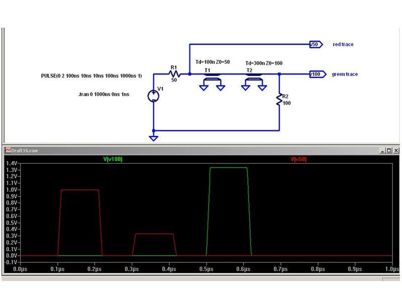

Here in thumbnail is a simulation of the mismatch using LTSpice. A back-terminated voltage source drives a 50-ohm transmission line, which is connected to a 100-ohm transmission line, terminated at the end. For 1 volt in,
VF1 = 1 volt
VR1 = 0.333 volts
VF2 = 1.333 volts
IF1 = +20 mA
IR1 = - 6.667 mA (note minus sign)
IF2 = +13.333 mA
So VF1 + VR1 = VF2
and IF1 + IR1 = IF2
Bob S
