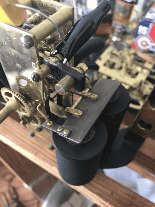

FWIW, I’ve been designing (OpenSCAD) & 3D printing replacement parts for this clock ...

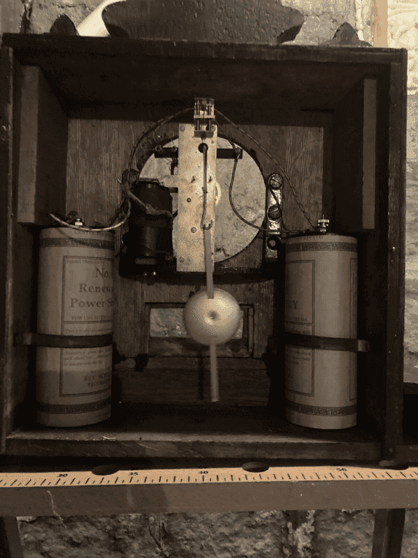

Additional detail
- manufactured in 1905 (so no useful part number)
- connected to 3V dry cell battery
- spool has some sort of steel core (a bit rusty these days)
- was connected in parallel with another electromagnet, side by side
(though in other examples of this clock, the two are in series ... mine appears to be an early, possibly pre-production example while they were still working out some kinks)
- correct, that second winding is not attached to anything
(maybe just a filler on the spool to lower the windings->length->resistance of the connect wire?)

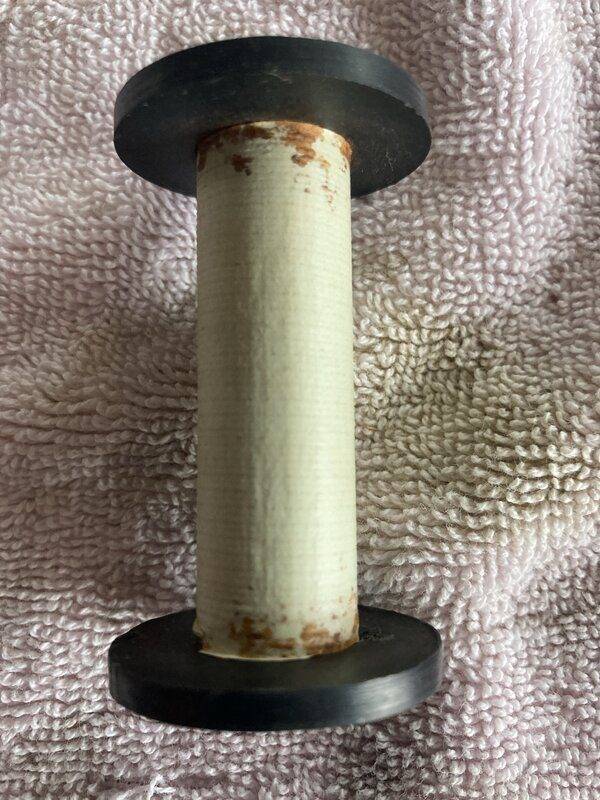

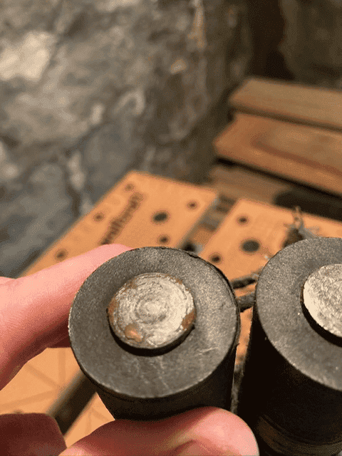

Spool

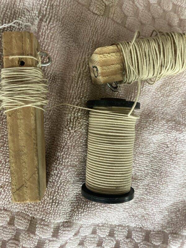

Partially unwound, showing 2 wires

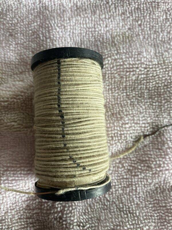

Fully wound

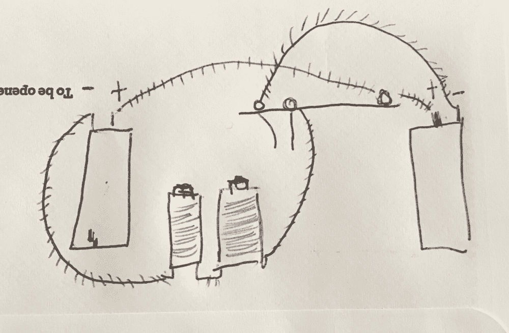

Map of circuit (sort of)
2 coils side-by-side

No timing circuit here per se - completely mechanical operation which completes the circuit, causing the electromagnets to fire and "wind" the clock (about once every 2 minutes ... it makes a bit of a racket frankly).

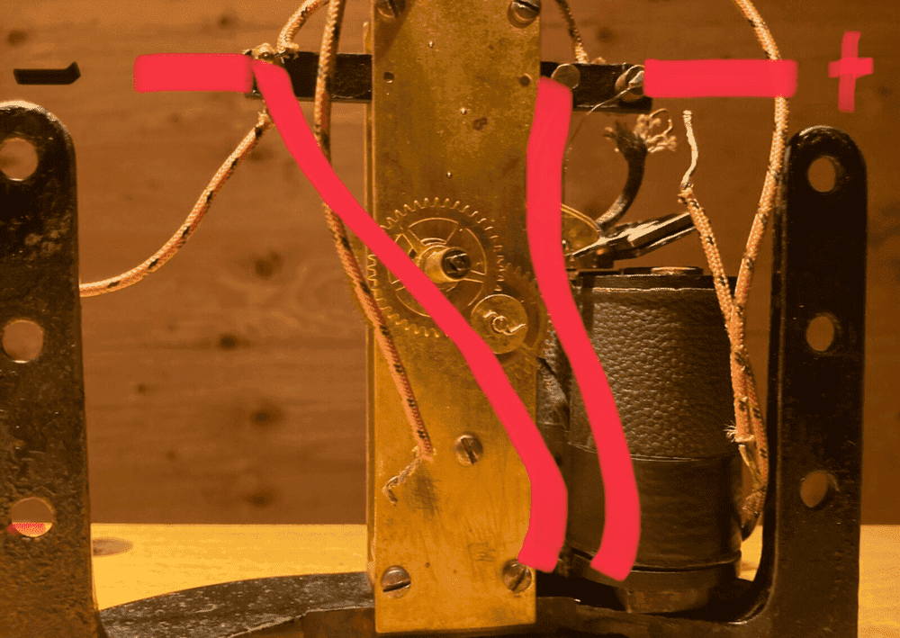

@flynnr2 can you make a schematic of how the insides are wired?
Not sure I can, but I'll give it a go at some point.
In words
- The thicker wire winds up & down the core 8 times and the two ends are connected to the circuit, exiting though 2 separate holes in the bottom
- The thinner wire winds up & down the core 8 times as well, in layers with the wire which activates, but the 2 ends are soldered together in a single hole on the bottom, not connected to anything else

Just want to be clear on terminology, I worry I might be confused by what you mean by "2nd coil" above
- there are 2 coils around solid cores
- wired in parallel (though some examples are apparently in series)
- each with 8 windings
- of the 2 different cotton sheathed copper wires
- the larger wires are connected to the circuit (3V)
- the larger wires are just a closed loop on each coil
- there are no resistors, etc.

- both wires are ribbon wound, side by side, 8 layers X 35 turns = 280 turns in total
- schematic drawn by a co-conspirator, smaller wire is not grounded or shorted, just a closed loop within the coil connected to nothing (shown on right)

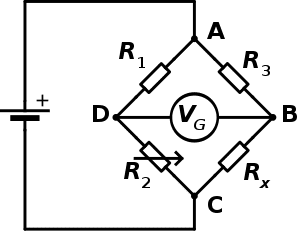

Research indicates multi-meters became common after the 1920's. Engineers circa 1905 could measure resistance using a Wheatstone bridge but would not have CRT's to view waveforms. One imagines they saw new circuits as cutting edge physics despite odd-to-us theories and terminology.
Wheatstone bridge circuit diagram for testing unknown resistance.
So if I am understanding the emerging consensus here (plus the reference, etc.) it seems like the looped, closed circuit wire may not serve any real purpose, so I could rewind that coil with just the wire connected to the circuit and have a perfectly serviceable electromagnet?

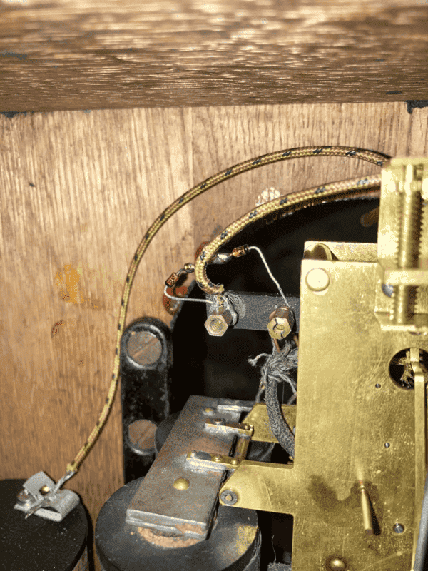

Empirically, arcing across the contacts which activate the circuit & electromagnets is a definite problem (not to mention some questionable metallurgical choice, which combined are probably one of the reasons this clock maker quickly disappeared), even with this second looped winding.
I have a couple of Zener diodes across the contacts to suppress this along https://www.electronics-tutorials.ws/power/transient-suppression.html:
Not quite period correct for 1905 perhaps, but works a treat.

BTW for those who are interested, I may not have done a decent job describing the mechanism, so here goes (some photos below as well) ...
  • As the clock ticks a few things happen with each tick (it is mechanical)
    • Two contacts which complete the electromagnet circuit get closer to connecting
    • A metal plate mounted on a pivot which the electromagnet attracts gets further away from the coils
    • A spring which drives the clock pendulum looses tension
      (the spring is also pulling down on the opposite side of the pivot from the plate)
  • When the contacts finally meet (about once every couple of minutes ...)
    • The electromagnet activates (obvs.)
    • Which attracts the metal plate to them
    • Which has the effect of both tensioning the spring as well as breaking the circuit by forcing the contacts apart (and causing that annoying arc, fouling the contacts, hence the 2 Zeners I have now in place)
  • Lather, rinse, repeat

Zener hack (test rig, not very pretty)
  • #31
In post #28 you show pair of back-to-back Zener diodes on an AC supply. You also show data for a MOV = metal oxide varistor.
Since you have a DC supply you only requires one power diode to suppress the flyback arc.
A single diode would keep the current flowing for longer after the contacts open because the reverse voltage across the coil would be less than with a MOV or the Zeners. Just make sure the diode and battery polarity are correct so it does not normally conduct.
The shorted coil would waste energy while turning on and extend the field while turning off. If you disconnected or removed the shorted coil, the single diode would go some way to compensating for the removal of the shorted coil.
