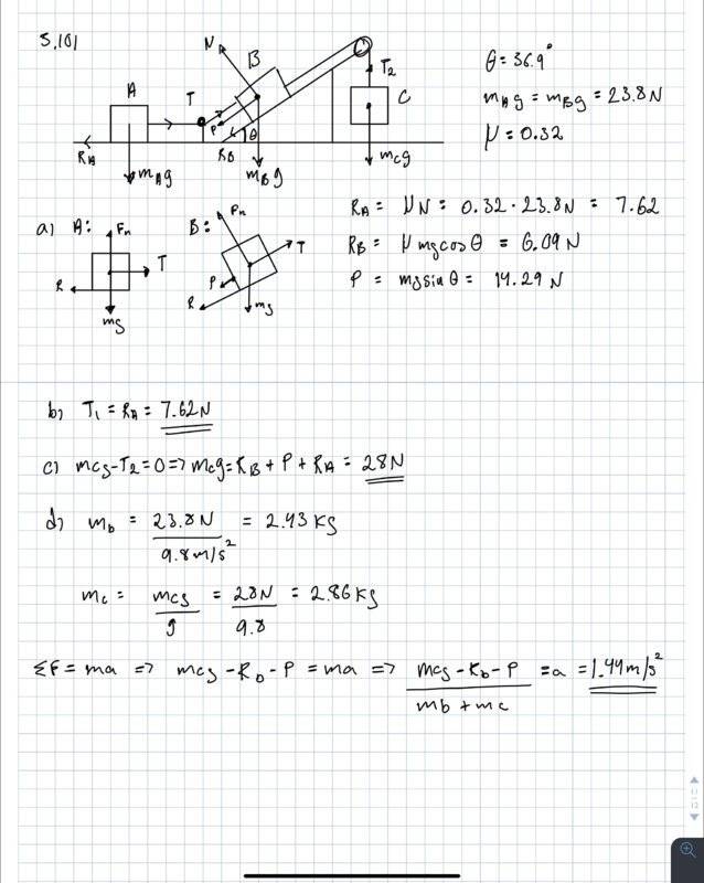

In summary, to find the tension in the rope connecting blocks A and B, we can apply Newton's first law and set the sum of all forces in the opposite direction equal to zero. This means that T-Ra=0 and therefore T=Ra. When calculating the tension in the rope connecting blocks B and C (T2), we must consider all forces working to the left, including P, Rb, and Ra, instead of just T2=P+Rb.
arianemati
Newtons 1st law, constant velocity
Sum F = 0
If I want to find the tension in the rope that connects block A and B. I can apply Newtons first law.
Sum of all forces in opposite direction equals 0.
The forces that work on block A is Friction (Ra) and the force on the rope that pulls the block towards the right (T) So we get T-Ra = 0 and therefore T=Ra. We don't look at the force T2 or mcg, or the friction working on block B.
So my question is. If we on block A only use the first force to the right and the first force to the left. (T-Ra) to find the tension in the rope connecting A and B . When we find the tension in the rope (T2) connecting B and C. Why do we have to calculate all forces that work to the left (T2 = P+Rb+Ra) instead of T2=P+Rb ?
