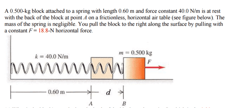

I need to find how close to the wall the block will come. Since there's no friction, I presumed there'd be enough energy, and only enough energy, to go the same distance d to the left of A. Also note that d=-0.2m. This answer is incorrect however. I don't understand. [/B]
AdkinsJr said:
2. Homework Equations
Conservation Mechanical Energy
Why do you think that ##d =0.2m##?
This is given.
AdkinsJr said:
This is given.
What's this force of ##18.8 N## then?
Oh, I'm sorry I didn't realize something was missing. The force is taken away at point B.
Do not assume the block is at rest at that point.
