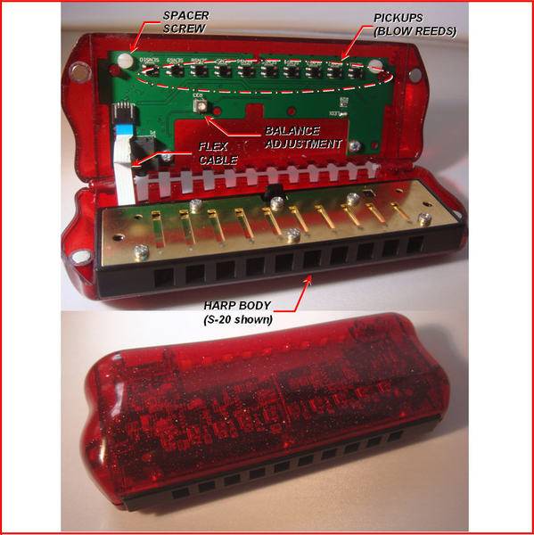

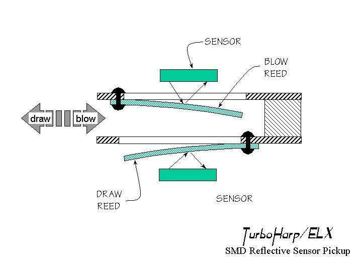

Regarding the illumination setup, I've attached a photo and diagram to illustrate the arrangement. The reeds are relatively reflective, made of polished brass/bronze.

I now see the physical layout and it's obviously fairly cramped in there! Looking at the way you have mounted the sensors. I have some relevant points to make, the way the angle of the reed affects the illumination of the photo transistor could be increased significantly. The light flux hitting the sensor will hardly be affected by the distance from the reed in its motion - it will be due to the changing angle of the reed deflecting light away from the sensor to a varying degree. I think, if you had the sensor units rotated 90 degrees from their present orientation. Also, if the sensor were positioned at the end of the reed, the variation of angle would be at least double what you could expect if it's placed as in your diagram. This would give a much bigger variation in the amount of light actually reflected to it. I think. A big deflection would direct the light to one side, completely away from the line joining source and sensor. Did you experiment with this or was it just an arbitrary choice?
You say that the noise you get is apparently proportional to the light level. This must imply, I think, that the light level hitting the sensor is not changed a lot as the angle of the reed changes. The angle of the reed won't ever be great - perhaps a couple of degrees at that part of the reed and the trigonometry of the situation (and any curvature of the reed would be producing a reflection image with a position that varies only slightly. This could even imply that a narrow slot over both detector and source would produce would produce deeper modulation as the image would be deflected right away from the sensor. Needless to say, there would have to be a compromise for the slot size - too small and too little light would get through for the detector to register.
From your picture, it looks as if the mods I am suggesting could all be incorporated - albeit being a pain to do a rebuild.

Regarding your suggestions on the light path etc., I do suspect that you are right about the light deflection due to the angular deflection of the target. On the other hand... the target is actually rather close to the sensor - within 2mm. And according to the Datasheet, the sensor is capable of sensing a flat object parallel to its face within that distance. (See attached Fig 1 from page 4.)
Of all the many assumptions and educated guesses that went into this design, the one meticulous thing I did was conduct a parametric experiment in which a single sensor was attached to a 3-axis stage. This permitted me to evaluate the sensitivity to x, y, and z positioning. I also did some angular sensitivity studies. I eventually configured the sensor layout so as to achieve the greatest amplitude signal but without buzzing against the reed (hence the reason they are not located at the tippy-tip.)
The illumination study that I did was less meticulous. I connected a single sensor in the most simple manner: with just a pull up resistor, and measured the voltage at the collector. Without exciting the LED, I illuminated the transistor with an old fashioned incandescent lamp, powered by a regulated supply. The result was white noise, audible as "hiss" when patched through an audio amplifier. Although I cannot say with certainty that it is shot noise, it is my best guess based on what I've read on various sources of noise, such as Johnson, Nyquist, dark, 1/f, etc...
That said, I do plan to try your experiment of masking the sensor with a slit. But the solution that brings me the greatest hope is your modulation/demodulation solution.

I am not sure about the reflective characteristic of brass, but the 960 NM would
reflect great with aluminum.
Maybe you could sputter the reeds with a few microns of aluminum to improve the
IR reflectivity.

I was looking at your picture again, maybe your noise is splash from the other
sources in the case.
How about a coat of black ink (flat) on all the brass surfaces except the reeds.
This would make the only reflective part, and the only moving part the same.
It also might help to look at this with a IR viewer (most digital cameras
can see some of the IR), and see how much IR is bouncing around inside your case.

@johnbbahm: I do like the idea of blacking the insides and dying the reed surface to improve wanted signal levels.

Improvement of IR Reflectivity:
JohnBBahm: How about a coat of black ink (flat) on all the brass surfaces except the reeds. This would make the only reflective part, and the only moving part the same.
….I am not sure about the reflective characteristic of brass, but the 960 NM would reflect great with aluminum. Maybe you could sputter the reeds with a few microns of aluminum to improve the IR reflectivity.
SC: I do like the idea of blacking the insides and dying the reed surface to improve wanted signal levels.
Jim: I’ve experimented with coloring the reed with both a black sharpee marker, and white-out. (The sensor datasheet uses both a reflective aluminum target and a white piece of paper.) The effect is negligible. Yet the signal intensity itself is surprisingly good: on the order of 50mV without any amplification – with just a pull up resistor.
