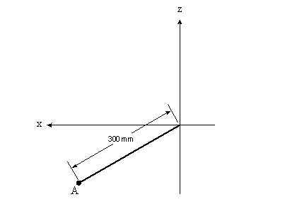

Yeah the B coordinates should be B(0,150,250) but i don't know what's wrong with the A coordinates especially the z one.
The plate is not horizontal, but inclined at 30°angle downward. 300 mm is the length of the edge.
ehild
300mm is the length of the edge which is the x coordinate, just like 500 which is the y coordinate.

Nope. Sketch the side view:
EDIT: Added point A to the diagram.

But isn't the y of point A at the end of the window and not at 0?
Yes. The sketch is looking along the y-axis (the y-axis is coming straight out of the page), so all y-coordinates will be seen as flat against the x-z plane. Point A is at the end of the heavy line, not at the origin.

sevag00 said:
So the y coordinate will be 300, right?
How do you get that? I thought we were talking about the x and z coordinates for point A.
sevag00 said:
So in this case, what is the coordinate?
I modified my diagram to show the location of point A (I thought it was obvious, but it never hurts to clarify). What x and z coordinates would you assign to point A?
So z=-300sin30 x=300cos30 and y=500.
Yes, that looks better.
