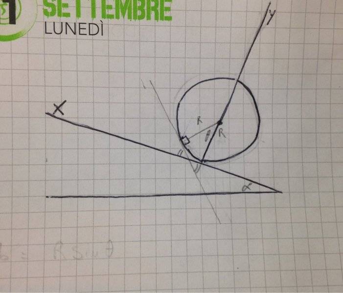

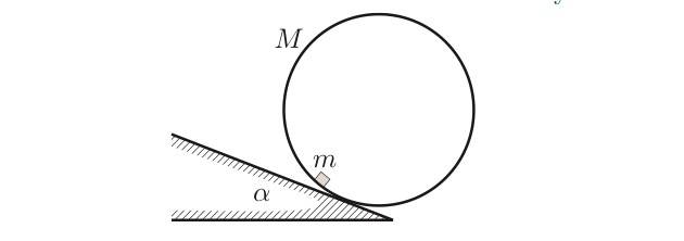

On an incline with slope angle α there lies a cylinder with mass M, its axis being horizontal. A small block with mass m is placed inside it. The coefficient of friction between the block and the cylinder is μ; the incline is nonslippery. What is the maximum slope angle α for the cylinder to stay at rest? The block is much smaller than the radius of the cylinder.
Well, I'm quite sure that I must consider the torques of M and m (maybe the origin of my XY plane can be the contact point between the cylinder and the incline). In this case the torque ## T_{M}= R M g sin \alpha ## but how can I write the equation of ## T_{m} ## ?
And is it correct to think that the two torque are opposite so until ## T_{m} > T_{M} ## the cylinder will stay at rest?

If a line from the center of the cylinder to the small mass m makes an angle ##\theta## to the vertical, can you express the lever arm for the torque ##T_m## in terms of ##\theta## and ##\alpha##?
Yes
The cylinder stays at rest as long as the two torques have equal magnitudes. Also, you don't want the small mass to slip.

If a line from the center of the cylinder to the small mass m makes an angle ##\theta## to the vertical, can you express the lever arm for the torque ##T_m## in terms of ##\theta## and ##\alpha##?.
Yes, but I don't know how to relate angle ## \theta ## with ## \alpha ##
Because I have a isoscel triangle ( 2 side of length ## R ## ). Any hint?
Is it possible that ## \theta = (90 - \alpha ) ##
θ is measured with respect to YR and YR is orthogonal to the plane X.

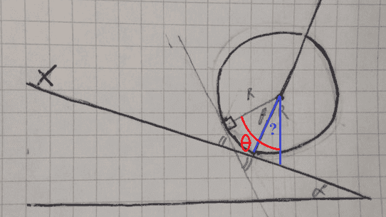

To find the lever arm for ##mg##, it might help to identify the angle shown with the question mark below
I was thinking of ##\theta## as being the angle shown in red below
The angle ? is ##\alpha##

Does ##\theta_1## represent your choice of ##\theta## or my choice of ##\theta##? (I'm not sure if the Y axis here is the axis perpendicular to the slope or perpendicular to the ground.)
Keep in mind that haruspex asked for the horizontal distance between ##m## and the center of the cylinder.
My ##\theta_{1}## is different from your choice of ##\theta##
Ohh well, the horizontal distance is ##R cos \alpha ##
