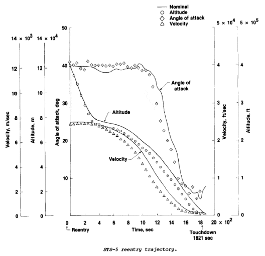

So I'm watching a documentary on supersonic flight, and the challenges they describe seem SO daunting that I couldn't help but wonder: Wouldn't it just be easier to fly above (most of) the atmosphere? There must be an altitude where sonic booms no longer reach the ground and wind pressure no longer superheats the surface of the plane. Would this be in the mesosphere? There is still oxygen there, so bringing it along would not be necessary.
I'm aware of SpaceShipOne, but with only three people on board, it looks more like a thrill ride then a transportation solution.

I'm probably misusing the term "suborbital" here. Wings can't generate lift in the mesosphere? If they could then something like Mach 3 might generate more manageable temperatures?

As the Shuttle came out of the bottom of the mesosphere (50Km), it had already transited the blackout zone and was traveling about Mach 9.
The chart below shows this happening for both the nominal case (t=1240, v=3200 Mach 9.3) and for the specific case of STS-5 (t=1170, v=3100 Mach 9.0).
The graph also shows that the rate of descent (slope of altitute line) is constant, indicating that it was generating about 1g of lift. The velocity is also a fairly constant slope showing a decrease of 1000M/s over 105 seconds or roughly 1G of drag as well - so 1.4G's total.
Obvious, there are more aerodynamic shapes, but the shuttle needed to contend with very high reentry temperatures. Your craft could do better. Still, skirting the bottom of the mesosphere would require an airspeed of roughly Mach 7 or 8 and substantial thrust to sustain that velocity.

.Scott said:
The graph also shows that the rate of descent (slope of altitude line) is constant, indicating that it was generating about 1g of lift. The velocity is also a fairly constant slope showing a decrease of 1000M/s over 105 seconds or roughly 1G of drag as well - so 1.4G's total.
Correction:
The graph also shows that the rate of descent (slope of altitude line) is constant, indicating that it was generating about 2/3 G's of lift - with the remaining 1/3 G's from the centrifugal force of that trans-orbital velocity. The velocity is also a fairly constant slope showing a decrease of 1000M/s over 105 seconds or roughly 1G of drag as well - so about 1.2G's total.
Note that this correction does not affect any of the remaining estimates. Your craft will get a similar weight relief from its velocity.
