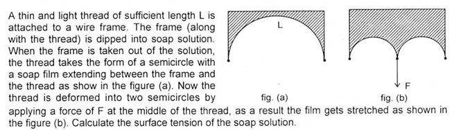

In summary, the homework statement asks for the force of surface tension on an object attached to a thread. I found that the force of surface tension is twice the length of the thread.
Saitama
4,243
93
(Ans: ##\pi F/(2L)##)
I am not too much familiar with these type of questions so I don't really how to begin with this. Also, I don't understand the question here. Do we have to consider it in the vertical or horizontal plane? I think its former because the weight of thread is balanced by force of surface tension. If it is so, here's what I have attempted:
For the first case, consider an element of ##Rd\theta## where ##R## is the radius of semicircle. The force due to surface tension can be resolved into two components. From symmetry, we need to integrate only the sine component. (##dF_T## represent the force of surface tension on the small part).
[tex]dF_T=TRd\theta \Rightarrow dF_T\sin\theta=TR\sin\theta d\theta[/tex]
Hence, force due to surface tension is twice the result of the above expression (as there are two sides, I don't know how to put it in words)
[tex]F_T=4TR[/tex]
As the weight of thread is balanced by force due to surface tension, ##mg=4TR##.
In the second case, the force due to surface tension can be separately calculated on each semicircular part by replacing R with R/4 in the above expression for ##F_T##.
[tex]F+mg=4TR/4+4TR/4[/tex]
But solving this gives me a negative value of T. :confused:
Any help is appreciated. Thanks!

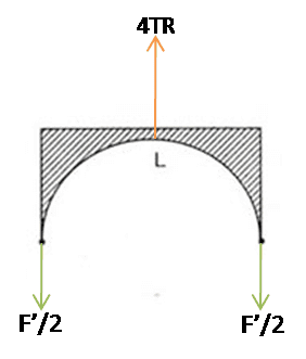

For case a), the FBD is as follows:

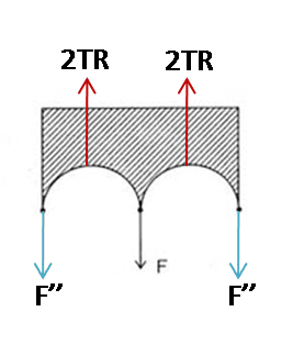

For case b),
Is ##F''## not equal to ##F'/2##? :confused:

I don't think ##F''## equals ##F'/2##. According to your picture, ##F'/2## is the force required to hold one endpoint of a semicircle of radius R. But ##F''## according to your picture is the force required to hold one endpoint of a semicircle of radius R/2.
This is a wild guess but is ##F''=F'/4##?
Yes. Think of the unknown force F as broken up into two equal parts: one part to hold the right endpoint of the left semicircle and the other part to hold the left endpoint of the right semicircle. The upward surface tension force of 2TR on the left semicircle is balanced by the two downward forces F'' on the left endpoint and F'' on the right endpoint. Similarly for the right semicircle.

TSny said:
Yes. Think of the unknown force F as broken up into two equal parts: one part to hold the right endpoint of the left semicircle and the other part to hold the left endpoint of the right semicircle. The upward surface tension force of 2TR on the left semicircle is balanced by the two downward forces F' on the left endpoint and F' on the right endpoint. Similarly for the right semicircle.
Thank you!
[tex]F+2F''=4TR[/tex]
Since ##F''=F'/4=TR##
[tex]F+2TR=4TR[/tex]
Solving, ##F=2TR \Rightarrow T=F/2R=\pi F/(2L)##.
This is the right answer. Thanks! :smile:

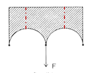

I did this problem two different ways, and got the same result, but the result was different from the answer given. I got T = 2F/L.
Method 1: Draw a dotted vertical line from the top of each semicircle to the top of the frame. Do a force balance on the central region (free body) between the dotted lines. There are no vertical forces acting along the dotted lines. The upward force exerted by the frame on the top of the free body of film is TL/2. The downward force on the bottom of the free body is F. Thus, F = TL/2
Method 2: Focus on the length of string between the bottom of the dotted line and the point where the force F is applied. Let θ be the angle along the arc. The differential arc length is Rdθ, and the surface tension force on the differential arc is normal to the arc, and of magnitude TRdθ. The vertical component of the differential force is TRcosθdθ. If I integrate this vertical component of the force over the entire arc length (θ=0 to θ=π/2), I get TR. There are two arcs that contribute to F, so F = 2TR = TL/2.
I think that the answer that was given in the OP's book was incorrect.

I am interested to learn about the two methods you tried Chet but first let me confirm if I am understanding your reply correctly. Are you talking about the red dotted lines?
Yes.

About your Method 1, Can we narrow down our region? What is the significance of having no vertical forces along the dotted lines? :confused:
  • #32
I used as a free body the region of film and string between the dotted lines. There are only two vertical forces acting on this free body, the force F downward, and the force of the frame at the top (pointing upward). The force of the frame between the dotted lines (pointing upward), by Newton's third law, is the same as the force of surface tension between the dotted lines acting downward on the frame.
