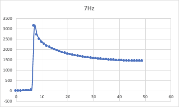

I would like to Derive the power spectrum of sinusoid.I tried like this. But It doesn't work.

When sinusoid frequancy is 7 and the sampling time series ##T=0.01s##, this is the power spectrum.
The paper I read says that "Only when the frequency of the sinusoid is equal to one of the Fourier frequencies will all power be concentrated in one bin of the discrete Fourier transform.", so I think the power spectrum should be delta function.
How can I derive the power spectrum as delta function?

Apparently your sums add up to non zero values for other frequencies. Under which circumstances can that happen ?
(hint: look at your homework equations :smile: )

As an example: Suppose your signal is ##\sin x##, under what circumstances can e.g. $$\int_a^b \sin x \sin 2x\ dx $$come out non-zero. Or, turned around: what are the conditions for $$\int_a^b \sin x \sin 2x\ dx \ = 0 $$

Did you guess the answer to my question ?
Read up on spectral leakage, windowing and such.
For your signal you want to make sure you integrate (sum) over an integer multiple of cycles (both from the signal and the sampling wave 2*π*j*k/N).
(With that I answered my own question :woot: )
