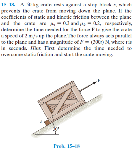

Time needed for a Force F to accelerate the crate to 2m/s? (Dynamics)
In summary, the conversation discusses a problem with finding the time when the velocity is 2 m/s up an incline. The speaker agrees with the book's answer of T=1.929s and mentions their mistake in equating the equation to 0 instead of 2. The other person thanks them for pointing out the error.
bardia sepehrnia
28
The mass of the crate, coefficient of static and kinetic friction is given. The force equation is also given.
F=300t

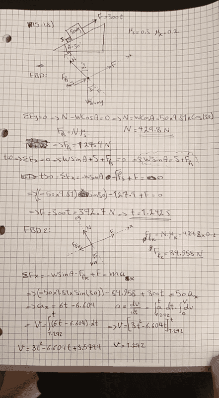

So above is the question. The picture below is my attempt at the solution:
242318
However the answer at the back of the book suggest that T=1.929s
I agree with the book. What did you do at the very last step? What does v=1.292 mean and how did you get it? You are supposed to find the time when the velocity is 2 m/s up the incline.
Likes bardia sepehrnia
Wow, I've been doing dynamics for too long today and been extremely tired and frustrated. For some reason I equated the entire equation to 0 where as you pointed out, I obviously had to equate it to 2. Thank you very much!
