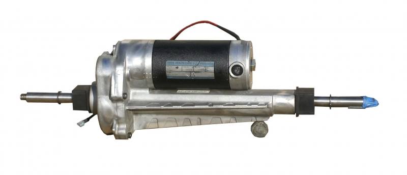

I'm working with a 3000 RPM @ 0.85 Nm motor in the transaxle from a powered scooter (like for disabled/elderly people). The differential has a 67:4 (16.75) reduction, which puts the output shafts around 179 RPM @ 14.23 Nm.
I'm passing this to a 25:9 chain drive, which makes the final output 64.4 RPM @ 39.5 Nm, or 29.13 pound-force-feet.
Each tire has an 11 inch radius, for a top speed of 6 feet per second, and a max thrust of 31.77 pound-force.
My question is, is the thrust at this point distributed evenly among 6 tires, or is it additive per tire? If I hooked a load to this this robot/ATV I'm building, would it stall at a 31 pound load with each tire providing 5.3 pound-force, or a (6*31.77 = ) 190 pound load with each tire providing 31 pound-force?
Thanks.

It's shared by the six tires. Power = force x speed. You have the same power and the same speed whether it's across six tires or one, so the total force must be the same.

The motor is made by Electro-Craft, a division of Reliance Electric.
Model number E675
Serial number G006497
Date code week 20 of 1997
Part number E675-07-042
3.375" or so diameter casing with a 1/2" diameter shaft

I'm trying to figure out how it functioned in it's designed life as a handicapped scooter motor. I am thinking the 0.85Nm on the label is an average/standard value, not a stall torque? Because I don't see how (per that calculation) it could have moved an 82Kg/180lb person generating only 62 Newtons of thrust from a dead stop. I could understand it during constant motion, but not under acceleration.

Original design is 4/67 differential gearing and 9" tires. That's it. I posted a picture of the entire motor assy a couple posts up.
I'm taking that assy, removing the wheels, and putting 9 tooth sprockets there instead. These then go to 25 tooth sprockets on the center axle. 12 tooth sprockets distribute to the outboard axles (1:1 of course).
The scooter weighed 200 pounds on it's own, with spec for a max 250 pound rider. My entire robot will be under 150 pounds when done (80 of that will be the car batteries).
