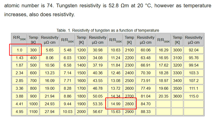

I have always been meaning to do this - thank you for providing the stimulus for me to do it!
I have just measured a 60W bulb for a 240V supply. At room temperature it was 80 ohms.
Now, if it consumes 60W when on, then 60W = 240 * 240 / R. The resistance when on is therefore ~960 ohms or 12 times greater..
See Resistivity of Tungsten which shows that at 2,800K (~2,500C) tungsten's resistivity is 14.99x higher than at room temperature.
Facts almost agreeing with theory - it must be my lucky day :cool:
Or maybe it runs closer to ~2,100C for 12.46x resistivity.
