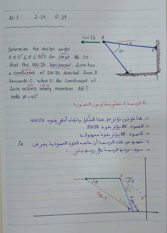

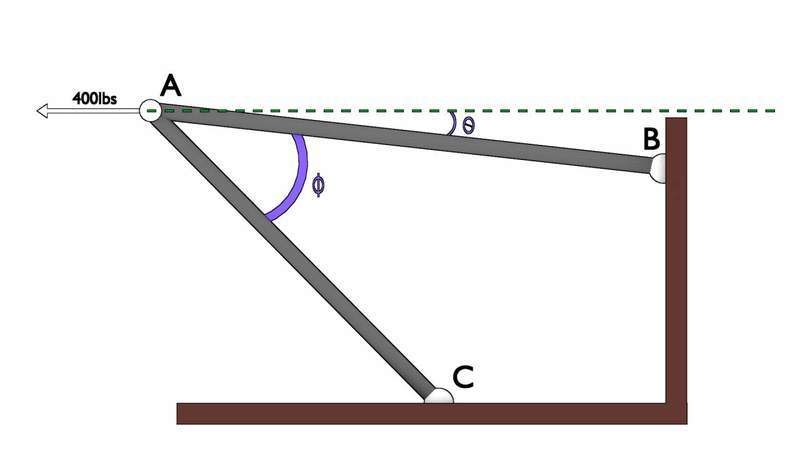

"Determine the design angle θ (0° ≤ θ ≤ 90°) for strut AB so that the 400-lb horizontal force has a component of 500lb directed from A towards C. What is the component of force acting along member AB? Take ϕ = 40°"
x-component: magnitude*cos(θ)
y-component: magnitude*sin(θ)
I understand what is being asked, I'm just unsure as to how I would get that AC component with what is given.
-Rybka

Hi Rybka. http://img96.imageshack.us/img96/5725/red5e5etimes5e5e45e5e25.gif
Take ϕ = 40°
Please correct this.

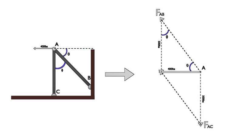

You have 3 forces, they must form a closed triangle. Struts exert their force in line with their length, so this tells you the directions of their contributions.

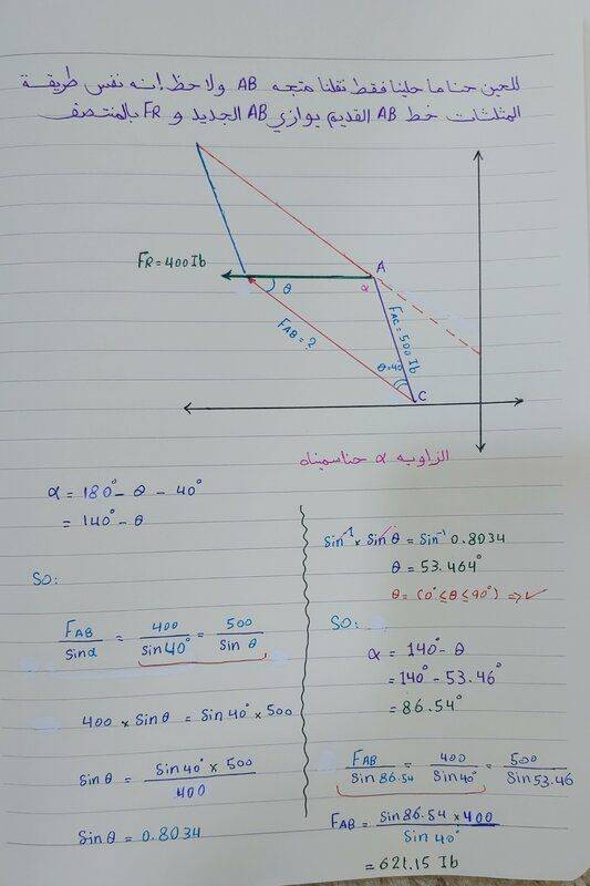

The solution is: θ = 53.5°, ForceAB = 621lb
I figured it out.
The position of the struts in the first diagram is confusing, but the fact that we're solving for θ means their shape is variable.
Once I moved things around a little bit, it all became clear. :smile:

It's always useful to know the answer. I was hoping you'd edit your post so it tells us exactly what is 40°. That would be useful for someone following along.

The problem in the drawing does not give accurate dimensions
