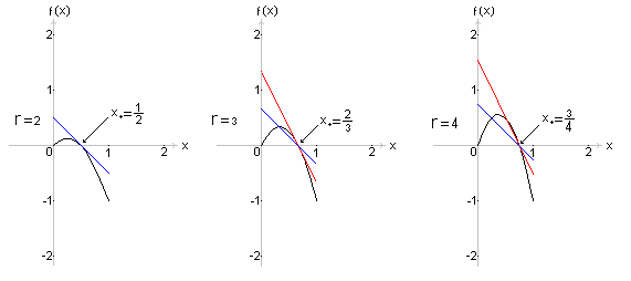

First step is writing the recursive relation as...
$\displaystyle \Delta_{n}= u_{n+1}-u_{n}= (r-1)\ u_{n} -r\ u^{2}_{n}=f(u_{n})\ ,\ r>0$ (1)
Second step is investigating the [qualitative...] behavior of the solution supposing r>1. The function $\displaystyle f(x)=(r-1)\ x- r\ x^{2}$ has one 'repulsive fixed point' [a point $x_{0}$ where is $f(x_{0})=0$ and $f^{'}(x_{0})>0$...] in $x_{-}=0$ and one 'attractive fixed point' [a point $x_{0}$ where is $f(x_{0})=0$ and $f^{'}(x_{0})<0$...] in $x_{+}=1-\frac{1}{r}$. An interesting property of f(*) is that for r>1, no matter what is r, is $f(0)=0$ and $f(1)=-1$. The reader can understand better what follows observing the annexed figure, where f(x) for r=2, r=3 and r=4 are reported. Now we examine different situations…
a) $1<r\le 2$. In this case the sequence will converge monotonically increasing [without oscillations...} at $x_{+}=1-\frac{1}{r}$. As example the case $r=2\ ,\ x_{+}= \frac{1}{2}\ ,\ u_{0}=.1$ is reported...
