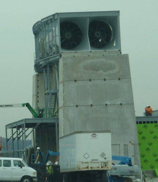

The way you "reclaim" this energy will be to have a closed-loop recirculating wind tunnel system, this would be a seriously big construction project considering you want to build one with a 6m diameter (this would officially be the biggest in the world, the largest right now is 5.2m). You should take a look at existing companies that make these kind of facilities, take for example http://aerodium.technology/en/models/models/recirculation/ which markets a http://aerodium.technology/en/models/models/recirculation/. They say their recirculating tunnels start at 1.5 million euro, probably for the 3m model; I have to think the 5m unit is at least 3-4 times as much...
It would take a team of engineers with specialized knowledge in aerodynamics to design a wind tunnel like you're proposing (not to mention quite a pile of money).
Take a look at the below source also, they estimate the construction of a 12-16 ft (3.6 - 4.8 m) recirculating wind tunnel facility will run between $7 million - $10 million USD. If you're wanting to build the biggest in the world, figure even more than that.

Near me in King of Prussia is a facility under construction that you can see from the highway that I assumed at first was a Lockheed Martin wind tunnel. Turns out it is an iFly indoor skydiving venue on an adjoining property (which probably explains why I wasn't arrested for taking pictures of it). It's an impressive facility that I would bet cost $5+ million. The duct appears to be two rectangles back to back, vertically, on one central shaft, with the fans on top. I'll post some pics when I get home.
