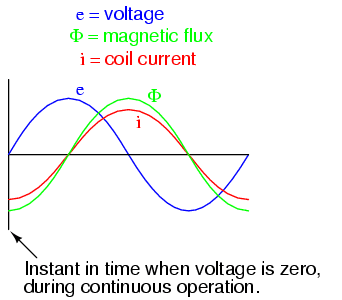

Here's normal operation. Focus on first half cycle of voltage.
e = n d[phi]/dt
observe that flux has positive slope over the whole interval where voltage is positive.
It starts from negative phimax not zero, and it goes to positive phimax.
phimax would be the knees of the B-H curve above in post 7.

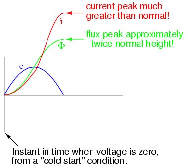

Now look at what happens when you have the misfortune to close your switch exactly on the voltage zero crossing.
Flux now starts from zero instead of negative phimax.
So flux goes to well past the knee of your B-H curve , and that's saturation. And it takes a LOT of current to push flux that high.
I never measured leakage flux during that transient but suspect it too spikes. There's plenty of mmf. I did measure peak currents 10X transformer's full rated current.

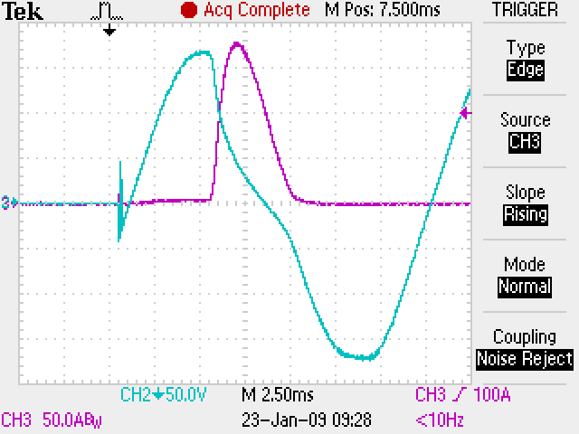

Anyway, here's the image for the 180 amp surge.
I have a linear power supply with a 400 VA toroidal transformer, and I put a current shunt in series with the primary winding (120 VAC here in the U.S.), and disconnected the secondaries from the rest of the circuitry. I set up an oscilloscope to capture the current in the primary and then applied line voltage. I turned the supply on and off a lot of times until I had captured the current surge when the primary voltage was applied just as the sine was crossing zero volts. The peak surge current was about 180 amps.
The grid voltage is applied to the primary of the transformer at about 2.2 cm (green). The current pulse (purple) doesn't even begin until about 5 mS later, at about 4.2 cm. This is because it takes that long for the flux to reach saturation (the flux is proportional to the integral of the applied voltage).
Notice that the current surge is so large that it pulls the grid voltage down when it occurs, just after the peak of the applied grid sine wave.
Likes Greg Bernhardt
Transformer core saturation is an evil thing...
Thanks Mr. Electrician !
That peak would have been higher yet had your voltage source been stout enough to deliver more current.
Where the purple trace leaps up is where the core saturated.
