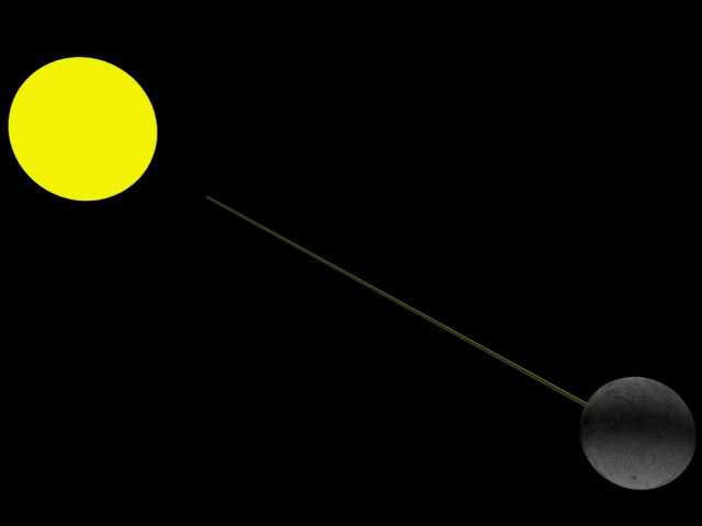

Here we have got a very long rod (100 million km length or so) built/placed on the lunar surface (near equator) and directed towards the Sun (imagine that Moon is in synchronous rotation with Sun and therefore that point (where this rod is built) is always looking at the Sun). The distance between these two celestial bodies is equal to 150 million km, so the rod covers two thirds of this distance. :smile:
I would like to know-will the Sun’s gravity destroy this rod? Rod’s closest point (relative to the sun) is 3 times closer than the points on the Moon, so the Sun will attract this end 9 times more than other end (according to Newton's law of universal gravitation its value is inversely proportional to the square of the distance between them)….so, what will happen? Will the Sun’s gravity be able to break the rod and attract broken piece(s)? Will the rod withstand Sun’s tidal forces? We know rod’s length, width, mass and all kind of property of the material that was used for manufacturing the rod (its specific strength for example), then what? :shy:
Mercury is about 60 million km from the sun and it is still there. If the rod is made up of strong enough material it should hold up.

The reason Mercury and the other planets are "still there" is because their diameter is small in relation to their distance from the sun. Tidal forces are caused by the difference in gravitational attraction between the nearest and farthest points from the sun.
If your rod extended between the Earth's orbit and mercury's, the "natural" orbital period of one end of the rod would be 365 days, but 88 days for the other end. Very large forces in the rod are required to make everything orbit at the same rate.
Making the rod thicker doesn't work, because twice the mass needs twice the force to create the required accelerations.
I am certain the rod won't remain intact. Let's ask a simpler question - on a "flat earth" (i.e. gravitational strength is independent of height), what is the longest rod that you can stand on its end?

You're talking about something 20 million times longer, albeit in a varying gravitational field. No way will it survive.

there must be a tensile stress in the rod, such that the stress gradient along the length is enough to keep the inner part of the rod from falling into the sun
I think that we should compare tensile strength (probably multiplied to rod’s cross-section’s are) with difference of Sun’s gravity at the end of the rod and its beginning….
