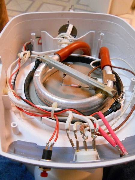

Hello everybody, I am trying to replace a power cord from a CBTL coffee machine. The cord, which was accidentally cut, has the following description. svt 300v, 18 awg, 105C. I have tried different shops around LA to find the power cord, but the best I was able to find was svt, 300v, 18awg, 75C. The only difference is the temperature. In a different shop, I was able to find the same power cord (the one with 75c), but instead of svt, it says stj. Will the temperature rating really matter much if I use the one I was able to find? I would really appreciate your advice on how to fix this issue and explanation of why it would, or wouldn't work. Thanks in advance.

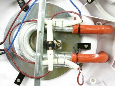

Inside a coffeemaker you'll find a very high temperature wire going from the heating elements to the power cord. It's insulated by white glass braid or some other high temperature covering. That's because the wiring is run physically close to both the boiler and the heating element underneath the carafe. Clearly both can reach boiling point of water plus a few degrees.
So 105C wire for the power cord makes sense, the inside of the appliance could conceivably get to 100C.
CPE is okay for excursions to 120C so should the coffeemaker be allowed to boil dry and overheat it won't melt the incoming insulation and go pyrotechnic.
So - in your case i'd call the coffeemaker's internal heating elements 'outside sources' because they're outside the wire even though they're inside the device.

When you open the cofffeemaker to replace your cord, study the connections to those heaters. I usually find them spot-welded so they'll handle the heat,.
The special high temperature wire i mentioned goes to the switch and thermostat controls for boiler and carafe heater, finally to the incoming power cord. Heat flows along wires just like current does, so you'll see considerable separation between the heating elements and the incoming cord.
While you have it open, place yourself in the shoes of the designer.
How did he arrange the internal wiring to keep heat away from the power cord?
those red and blue wires will have a high temperature insulation probably braided glass fibers.
This guy has rewired a coffeemaker with ordinary lampcord, which is dangerous. He should have transitioned to high temperature wire at the rear entry not at the front switch. Beware of internet advice...

Good luck, and don't set a trap like the guy in that photo above. Disasters always result from domino effect on seemingly little things..
