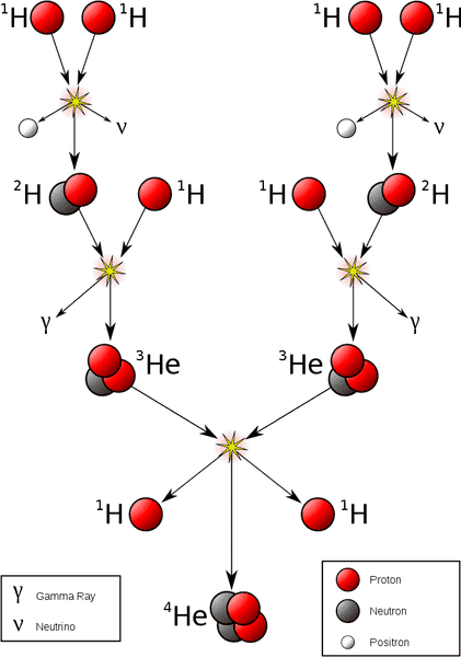

That's a fair question.
First, there was some Helium produced in the big bang, so not 100% of the first stars was Hydrrogen. But I think the real answer to your question is this:
https://en.wikipedia.org/wiki/Nuclear_fusion#Nuclear_fusion_in_stars said:
The proton-proton chain dominates in stars the size of the Sun or smaller.

In the Sun, deuterium-producing events are rare. Diprotons are the much more common result of proton-proton reactions within the star, and diprotons almost immediately decay back into two protons. Since the conversion of hydrogen to helium is slow, the complete conversion of the hydrogen in the core of Earth's Sun is calculated to take more than 1010 (ten billion) years.

Deuterium is the isotope of hydrogen with one neutron and one proton. It can be produced by the reaction at the top in the diagram anorlunda posted above: two protons combine, emitting a positron and and a neutrino and turning into deuterium.
