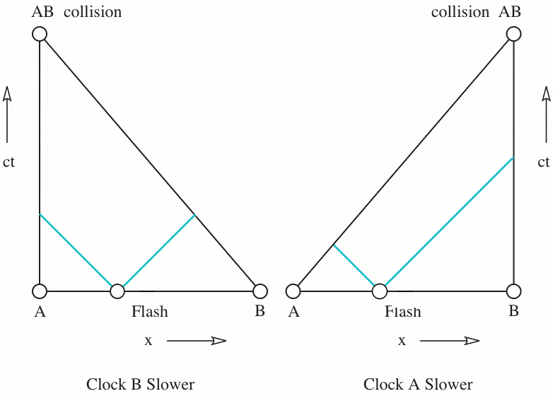

AntigenX,
Also you will notice that I have stressed several times throught the thread to suggest some method of starting the clocks simultaneously for at least one observer.
This diagram illustrates a method for M to send 2 light pulses so that A and B's clocks agree momentarily at the orange line. Red lines are light beams.
So when A sees his clock reset, he knows that if he had instantaneous comms ( horizontal line ) he'd see B's clock reseting as his does.
I have not tried to work out the times involved.

  • #51
In A's rest frame.

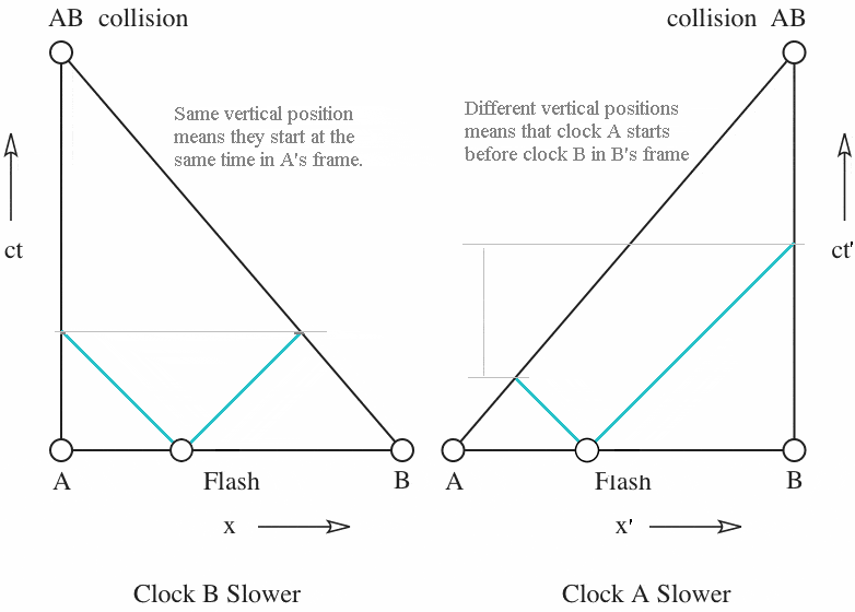

Yes, it is perfectly possible to arrange things such that both clocks start simultaneously for any given observer. For instance, by placing the origin of the flash closer to A than to B, (as shown in the attachment)you can have both clocks start simultaneously as far as A is concerned.
With such an arrangement, according to A: Both clocks start simultaneously. B runs slower during the period before collision and then after both clocks have stopped will have accumulated less time.
So according to A, B "really" runs slower.
However, according to B: Clock A starts significantly before clock B. B runs slower than A until the collision. After A and B stop, B will have accumulated less time than A even though A ran slower than B. This is because clock A had accumulated a great deal of time before clock B even starts.
So according to B, A "really" runs slower, but it also "really" started ticking sooner.
You can't just look at the accumulated time on both clocks at the end, and say which clock "really" ran slower.
I think the part of the problem you are having is that you are equating "real" with "absolute", that unless you can say which clock absolutely ran slower, can dilation isn't "real".
But time itself is relative and not absolute, and relative time measurement is as "real" as time gets.

Hi AntigenX,
Yes, it is very easy to see from the space-time diagram. See attached.

You are correct, sorry I was too lazy to edit it correctly. There are four events of interest:
1) the flash (labeled with a circle)
2) the collision (labeled with a circle)
3) clock A starts (no circle, the intersection of the flash and worldline A)
4) clock B starts (no circle, the intersection of the flash and worldline B)
The other circles are indeed not representative of any event, and the horizontal line connecting A Flash and B is also not representative of anything. Also, I think it is usually useful to show both frames coordinate axes on each drawing.

Hi AntigenX,
I am going to make a shot at making an analogy that might help with your understanding of simultaneity (or confuse the heck out of you) but here goes.
For the analogy I am going to use sound instead of light. Imagine you stretch your arms out and click the fingers of your left and right hands at the same time. Your arms are the same length and you hear the left and right clicks reach your ears at the same time. For this anology we will pretend that your nervous system operates much faster than the speed of sound and is effectively instantaneous in comparison. Now you get on a superfast powered scateboard with your left arm stretched out in front of you and your right arm behind. When you click your fingers again, the sound from your left hand reaches your left ear before the the sound from your trailing right hand. You decide to synchronise your hands and click your right hand slightly before your left hand so that the left and right clicks arrive at your ears at the same time when cruising superfast on your scateboard. Now you pass some observers standing next to the road who just happen to be standing next to each of your hands when you clicked them and they say you did not click them at the same time. Now of course you also know that you are not clicking your the fingers of your left and right hands at the same time, but in relativity using light signals there is nothing faster than light to compare the light signals with, so you can only rely on the simultaneous arrivel of two signals from two events that are the same distance away from you to tell you that the two events happened at the same time. Observers that are not moving at the same speed as you will not agree that those two events occurred at the same time.
To answer the question of how A and B decide which clock started first, draw a vertical line that is midway between the clock start events in each of the reference frames. Imagine the clocks are programmed to flash back an echo signal when they start. Now all they have to do is notice if the echoed signals return to the midpoint at the same time. If the echoed start signal from one of the clocks arrives at the center line first, they will decide that is the clock that started first. In this particular case A decides the clocks start at the same time while B decides the left hand clock (belonging to A) started first.
