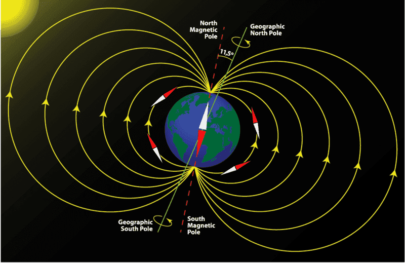

  • #34
The magnetic field of the Earth can be modeled as a magnetized needle with its north magnetic pole (red) near the geographic South pole (see figure). Compass needles line up with the local field lines to minimize the potential energy. Thus, the north magnetic poles of the compass needles on or near the Earth's surface will point in the general direction of the Earth's geographic North.
Likes bob012345 and Delta2
  • #35
It's drawn correctly but, from a physics point of view, it's incorrectly named in the above diagram: the pole in the north of the Earth is the magnetic south pole and vice versa. It's of course the usual terminology to call the south pole of the Earth (seen as a magnet) the "northern magnetic pole". That always leads to the confusion and the discussion we have right here.
The following picture from Wikipedia is even more explicit:
https://upload.wikimedia.org/wikipedia/commons/2/2b/Geomagnetisme.svg
It's much clearer, not to mention the Earth and compass needles first but just use magneto statics a la Ampere and define everything in terms of vectors (magnetic field, ##\vec{B}##, and, if you want to deal with permanent magnets, magnetization).
