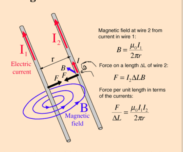

So the picture is this.
Basically an application of amperes law and Newtons third law shows that they attract.But what about from the frame of reference of the moving currents. Say I have a stream of charges moving to the right, and another stream of charges moving to the right. Both with same velocity and charge density.
Well, in the frame of reference of the moving charges, I just have one row of charges and another row of charges below it. They exert electric forces on each other but not the magnetic force since in this frame, none of the charges are moving relative to each other. If I look at one charge, the left and right charges' effects from the same line cancel. And the left and right charges' effects from the line below will add positively in the vertical while only canceling in the left right direction. And of course, the charge directly below will exert a net force up. In the end, the two currents should be repelling each other when viewed from the frame of reference of the currents.
What resolves this?

Let's do a simpler case first. Consider a wire along the ##z## axis carrying a current density ##\vec{j}##, i.e.,
$$j^{\mu}=\begin{pmatrix} 0 \\ j \vec{e}_z \end{pmatrix}, \quad \rho<R,$$
where ##R## is the radius of the wire and ##\rho=\sqrt{x^2+y^2}## the usual cylinder coordinate.
Using a circle parallel to the ##xy## plane with radius ##\rho>R## in Ampere's law with the ansatz ##\vec{B}=B(\rho) \vec{e}_{\varphi}## leads to
$$B_{\rho}=\frac{I}{2 \pi c \rho}, \quad I=\pi R^2 j$$.
Now consider a charge ##q## running with velocity ##\vec{v}=v \vec{e}_z## along the ##z## axis. The spatial part of the Lorentz force is
$$\vec{K} = mc \frac{\mathrm{d} \vec{u}}{\mathrm{d} \tau}=q \vec{u} \times \vec{B}=-\frac{\gamma q v}{c} B_{\rho} \vec{e}_{\rho},$$
where
$$c \vec{u}=\gamma \vec{v}=\frac{\vec{v}}{\sqrt{1-\vec{v}^2/c^2}}.$$
Since further ##u \cdot K=0##, the time component is given by
$$u^0 K^0=\vec{u} \cdot \vec{K} \; \Rightarrow \; K^0=\frac{\vec{v}}{c} \cdot \vec{K}=0.$$
So we have
$$(K^{\mu})=\begin{pmatrix} 0 \\ -\frac{\gamma q v}{c} B_{\rho} \vec{e}_{\rho} \end{pmatrix}.$$
Now consider the same situation in the rest frame of the particle. We have to Lorentz boost with ##\vec{v}## in ##z## direction, such that in the new frame ##u^{\prime 0}=1##, ##\vec{u}'=0##, i.e., with the Lorentz matrix
$$({\Lambda^{\mu}}_{\nu})=\begin{pmatrix} \gamma & 0 & 0 & -\gamma v/c \\
0 & 1 & 0 & 0 \\ 0 & 0 & 1 & 0\\
-\gamma v/c & 0 & 0 & \gamma \end{pmatrix}.$$
This immediately leads to
$$K^{\prime \mu}=K^{\mu}.$$
Now, how comes this force about in the rest frame of the particle? That's easily answered by taking the Lorentz transform of the current vector,
$$(j^{\prime \mu}) = ({\Lambda^{\mu}}_{\nu} j^{\nu}) = \begin{pmatrix}-\gamma v j/c \\ 0 \\ 0 \\ \gamma j\end{pmatrix}.$$
As we see, there's a charge density ##\varrho=-\gamma v j/c^2##. If you evaluate the corresponding electric field you get
$$\vec{E}=-\frac{\gamma v I}{2 \pi c^2 \rho},$$
and you see that the force is precisely the electrostatic force on the particle at rest in the new reference frame,
$$\vec{K}'=q \vec{E}.$$
So everything is consistent.
You can of course generalize this to the charges in a second current conducting wire, using the superposition principle.
