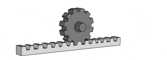

For that reason, a car can happily roll forward while is cornering hard: the persistent and strong static friction of each little area of successive contact patches prevents the car from sliding out of the curve.
If the cornering force is strong enough to overwhelm the static friction, a slide starts (dynamic sideways friction) and does not stop unless some other condition changes, because its value is always smaller than the value of static friction.
Think of a rack and pinion mechanism: you have smooth rolling with tenacious grip (think huge static friction) between wheel and linear gear:

Consider the case of a cogged wheel rolling down a cogged straight rail, with the cog teeth meshing. Although the meshed cogs do not fit the definition of static friction, they can illustrate the essential concepts. It would be very hard for the wheel to slide down the rail without rolling; it might require breaking the cog teeth. That illustrates the concept of static friction. On the other hand, there is very little to stop the wheel from rolling down the rail. That illustrates the concept of rolling friction. In general, static friction is much greater than rolling friction.
Likes sophiecentaur and Lnewqban
