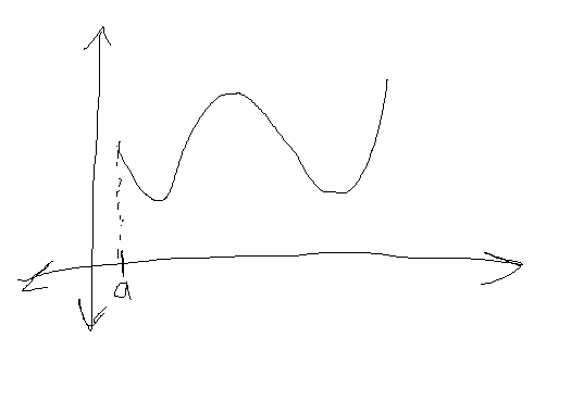

Why is 'a' not a local maximum?
According to the definition of a local maximum, I have to take an open interval around 'a' so it seems like 'a' is a local maximum. I don't understand why it isn't.
Definitions vary somewhat. If the domain you are interested is only a finite interval I, an end-point such as x = a is often regarded as a local maximum, since it satisfies the definition that f(a) >= f(x) for all x in I, |x-a| small. Typically (although not always), optimization textbooks would use this type of definition, since it fits exactly with practical needs (which is to find the best value of the function, no matter where it happens to be located). However, general math textbooks might use a different definition. So, the best advice is: go with the definitions used by your instructor and/or textbook.
RGV
I am just severely confused because the textbook states that the right endpoint on this graph is a maxima as well, but the left endpoint is not.
The right end point is an absolute maximum.
The left end point is a local (but not absolute) maximum.
Okay, so the textbook has an error then, I guess.

Yes, unless the domain is not limited on the left side at a.

Assuming the right hand end point is b, is the function defined on [ a, b ], or is it defined on ( a, b ] ?
Interesting distinction! ;)
According to the definition on wiki there is no local maximum at a on (a,b].
However, every practical application shouts that there is and there should be.
Since there is no specific reference to this situation in wiki, in my book that means that wiki's definition is flawed.
No: Wiki is correct. Take an easier example: what is the minimum of f(x) = x in the region x > 0? Answer: there *isn't* one. There is an "infimum", but not a minimum. If you don't believe this, please tell me what the minimum is.

I could, but I won't bother, as the definitions are rather standard: a (local or global) minimum is a (local or global) infimum that is *attained*---that is, there is some allowed value of the variable that gives the infimum. For an open interval, and endpoint is not an "allowed" value. In practical terms the distinction is not that important, because if the infinum is 1 (say) and is not attained, in a practical application we could use instead an attainable value that gives, say 1.00000000000000000000000000000000000000001. But, in theory, there is always going to be a difference.
