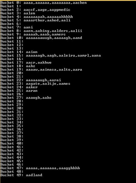

So I created my own implementation of a hash set of strings and am XORing the characters as a hashing function:
Code:
        private int _GetBucketNumber ( string s, List<List<string>> Buckets )
            //       s: string whose index to look up
            // Buckets: source buckets
            // disallow empty or NULL strings
            if ( String.IsNullOrEmpty(s) ) { throw new ArgumentException("Cannot add empty or NULL string to set"); }
            if ( Buckets.Count == 0 ) { throw new ArgumentException("Tried to call _GetBucketNumber on empty bucket list"); }
            // XOR characters together and mod by length of buckets
            char c = s[0];
            for ( int i = 1; i < s.Length; ++i ) { c ^= s[i]; }
            return (int)c % Buckets.Count;
Problem is that it's not doing a good job of distributing N strings into N buckets. For instance, I initialize it with 50 buckets and add in the first 50 words of http://www.math.sjsu.edu/~foster/dictionary.txt and it ends up like
Now I know that's not the best example since the first 50 words (alphabetized) are very similar in characters, but I've tested it out with random strings and it does the same thing.

All the lowercase ascii characters agree in many of their bits, I guess you cannot fill more than ~30 buckets with that method. All the "a" don't make it better (note that adding two "a" to a word doesn't change the hash at all).
Check the concept of avalanche - https://en.wikipedia.org/wiki/Avalanche_effect If your data is going to be from a known ,maybe large, set of values you can use one of the perfect hash tools - feed it all possible data and it constructs a hash with no collisions for that data set. Or a subset of that. This has the advantage that you do not need code to detect and handle collisions.
gperf is tool for that - https://www.gnu.org/software/gperf/manual/gperf.html
Examples of more general hashing algorithms: http://www.eternallyconfuzzled.com/tuts/algorithms/jsw_tut_hashing.aspx
Why not do a more controlled experiment like three letter sequences? i.e. aaa,aab,aac, ... xxx, xxa, xxb, xxc
If your algorithm is working I'd expect aaa to be in one bucket and aab to be in the next... or some such order as that

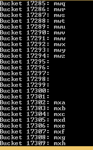

Ok, with the knowledge that the range of possible values of inputted strings is 'aaa', 'aab', ..., 'zzz', I changed my function to

and of course that worked perfectly. But I want mine to be general enough to work arbitrary strings.
Well, xor of ascii will not give a good hash function, no matter how exactly you implement it.
You can generalize your 3-letter approach to arbitrary strings. It is still not a good hash function, but better than xor.

That eternallyconfuzzled article is really good. I implemented the Bernstein hash and it worked out well:

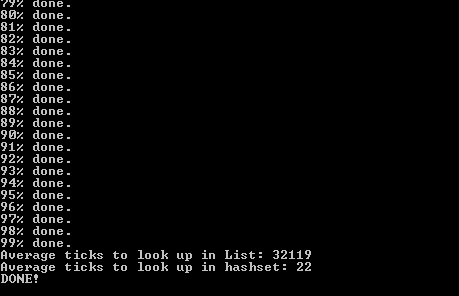

Alright, check this out:
That is the result of my performance test

Thoughts?
Likes FactChecker
That is very interesting from a learning point-of-view,
For professional programming, you should use the tools that are already in the language. Many languages (C++, Perl, Python, etc. ) already have a hash (aka. associative array, map) implemented. They work well, take care of collisions, allocate memory, etc. The C++ map is a hash implementation. The implementations in the language will probably be optimized in ways that are hard to compete with.

I ran the same test with an English dictionary of ~350,000 words. The test took over an hour to run and here are the results:
That's a 1460x difference in performance. Wow.
What do you look up how? A binary search in a sorted list should not take more than 19 accesses with 350.000 words, and it avoids any hash collisions, so I don't see where the factor 1460 comes from.
That is my computed difference in performance of lookup between having the 350k words in an unordered List<string> versus the StringSet class that I created.
Ah, unordered list. Then it is not surprising.
