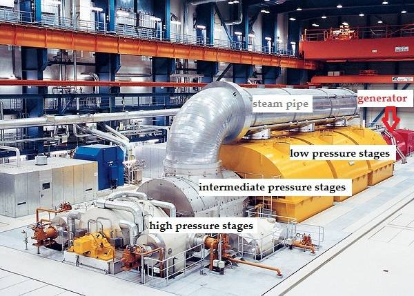

A common sense questions. Can anyone care to provide their insights?
saadsarfraz said:
A common sense question.
really ??
haven't seen that before, do you have an example ?
In my opinion, it is an usual system: what we call “ a steam turbine” are 3 turbines acting on the same shaft: high pressure, intermediate and low pressure. A gas turbine could be two in series-in combined cycle power plant.
Likes jim hardy
Can it be because having a single generator is less costly and would be more efficient as multiple generators would lead to some type of internal losses due to resistance or friction...
Likes Babadag
Those multiple turbines are probably connected to the same shaft. Even though they have several sections, we call them collectively "a turbine"
Sometimes we have cross compound turbines with multiple shafts and multiple generators but one steam path. That's rare today.
Likes dlgoff and davenn
What type of turbine? Steam, gas, ? Is this a Co-gen with Heat Recovery Steam Gen?
Are you speaking of central power station equipment?
Common sense ? Look up KISS principle. One turbogenerator with multistage turbine of course .
all on one shaft...
Likes russ_watters and fresh_42
