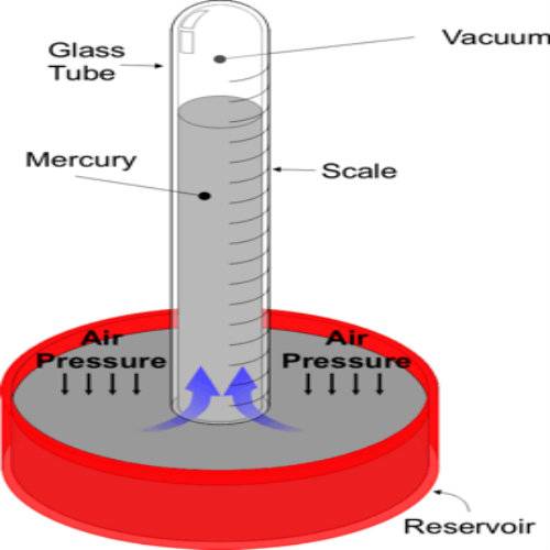

Imagine some giant glass(or other material) dome placed on top of some ocean or lake. Then pump some air out of this dome, until the water level rises a few meters under the dome.
Place another dome below the first dome, and repeat the process, resulting in a little less pressure in the second dome.
Keep repeating this, until the pressure in the final dome is low enough to get water boiling at room temperature.
Would such a device work or did my thinking go wrong somewhere?
The picture below shows how I imagined it.
Yes, but why bother with more than one dome?

I'm not following: since the large dome covers all the little domes, you only need to pump out the large dome to the pressure where the water level reaches what you show in the pic (about 33 feet, at room temperature). No other domes needed. Are you thinking the vacuum is greater with the extra domes or something?
edit:
What you have there is very much like a mercury barometer, just larger and using water:

Well, ok; if the pump you are using is only capable of a progressive fraction of a vacuum (eg, 1/4 atmosphere per step would mean 4 steps), then I guess you'd need multiple domes. But any decent vacuum pump would be able to do it in one step.
However, if as you say, you could get a great enough vacuum to boil water at room temperatures with a tall enough dome, with enough "vacuum space" on top of the water level, then I guess only 1 dome is required for my follow up questions.
You need the single dome to be equal in height to your largest dome regardless of how many steps you use. It needs to be >33 feet.

I'm not sure why you would think that last part. In order to maintain the boiling you have to maintain the vacuum. That means you need to be constantly applying a force to the cylinder (and moving it) to maintain the required vacuum pressure to make the water continue boiling. There is no energy extraction here, only continuous energy input.
Note, this also assumes the water will absorb heat from the surroundings fast enough to remain roughly at the starting temperature. Otherwise the process slows down.

You'd have to draw me a picture with labels because I'm not clear on what you are saying. But in the picture you drew in the first post, the height of the water is 33 feet.

It doesn't suggest anything of the sort, since it provides no measurement of pressure and doesn't have a piston or anything else to indicate the pressure has risen once it starts boiling -- you're filling in the blanks with your imagination...
...but can't you hear the vacuum pump running continuously throughout the duration of the experiment? If that isn't enough for you, try putting some numbers to what you think is happening and check the actual properties of water and steam against them.

Yes! Because you didn't need a vacuum pump to create the vacuum! But for your setup, if you attach a turbine at the top, you're just using your vacuum pump to create airflow (and steam flow) to spin the turbine!

The system would reach equilibrium with an atmosphere consisting of water vapor at exactly the right pressure and temperature so that evaporation and condensation are taking place at identical rates. No boiling.

There are two ways to look at it:
1. The scenario you describe would run for the planet until the oceans boiled away or reached equilibrium, just like in your vacuum jar with the pump shut off.
2. The Earth already has a thermodynamic cycle involving evaporating water, heated by the sun - it just doesn't work the way you describe.

I'm sorry, but it isn't just wrong, it is gibberish.
Or to put it differently. I imagine the water like a spring, which the sun pushes together in a sense, storing energy in the water.
Water isn't like a spring. That's gibberish too.
At this point, I'm going to close this idle speculation/personal theory/attempted perpetual motion machine thread.
