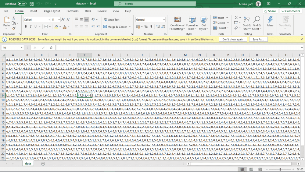

I get this
It looks like you have generated a valid CSV file but have loaded it into EXCEL wrong. Did you tell EXCEL to use comma separation when the file is opened into EXCEL?
Arman777 said:
I get this
Open the file in a text editor; it should be values separated by commas on each line. That's a CSV file.
Excel might not be loading it properly. The line ending character you are using is for Unix/Linux, so if you're on Windows or MAC Excel might not be properly interpreting it. Also there might be character encoding issues; as your code is written it will save the file with the default encoding of whatever Python you are running, probably UTF-8; but Excel might not default to UTF-8 when loading. Finally, Excel's definition of "CSV" might not match the standard one; you might have to explicitly tell it that the field separators on each line are commas and not something else. (I would lean towards the last of those since it looks like the lines are being separated properly and the characters are being read properly.)
how can ı do that ?

Actually, you do need to get Excel to load it properly, rather than do the post-hoc fix I proposed. I think Excel won't store more than a certain number of characters in a cell, so you will get data loss if your lines are too long.
Try changing your program to create data.csv instead of data.txt. Excel ought to recognise the extension.
I am already creating data.csv see post 3
Sorry - I was looking at the version in post #1.
How are you opening it? I don't have a Windows box to hand to play with, but my recollection is that Excel does different things if you open the file with drag-and-drop, double click, and going through the File->Open menu. At least one of them ought to pop up the same dialog as the Text-to-columns menu option.
hmm that's the problem I guess. So I am using vs code and it looks like this
as you can see it says data.cvs
And when I look it from the folder view, I see
I am just clicking data.csv to open the file. Thats how I get

The behavior of Excel depends on the regional settings in Windows. In some countries, comma "," is used as decimal separator instead of point "." character. In such case, comma "," cannot be used to separate values and Excel uses semicolon ";" to separate the values instead.
@Arman777, that would explain why the standard CSV is not automatically loaded into table format when you open it. Instead of overwriting the regional settings you can explicitly tell Excel what character should be used as separator as already mentioned in previous posts. Or you can keep using semicolon if it works well with your settings, but you should keep in mind that it might cause troubles to other users with different settings, in case you plan to distribute the file.
Likes cgrie, FactChecker, Arman777 and 1 other person
This tells excel to load the text file into the first column of the spreadsheet rather than import the text as a spreadsheet. This is a spectacularly bad and frustrating mode of operation. I would consider it a bug. I usually use LibreOffice when working with text type spreadsheets as it imports by deafult when you open them and it also handles them better in my opinion. Pasting into it also works better than Excel.
Follow the instructions Ibix posted in #16 and you will be good to go.

"cell data", "cell2 data", "cell3 data", "data with , is fine", "data with a quote "" requires that the quote be doubled", "another data item"
It's not that bad--just check each data item and escape any double quotes as "" first, THEN add it to the current line of text. Delimit as always. Each line starts and ends with " and "," goes between each data item.
Likes FactChecker
What is a CSV file?
A CSV (Comma Separated Values) file is a plain text file that stores data in a tabular format, with each row representing a record and each column representing a field. It is commonly used for storing and exchanging data between different software applications.
How do I write data into a CSV file?
To write data into a CSV file, you can use a programming language like Python or a spreadsheet program like Microsoft Excel. In Python, you can use the built-in csv module to create and write data into a CSV file. In Excel, you can simply save your data as a CSV file by choosing the "CSV (Comma delimited) (*.csv)" option when saving.
What are the benefits of using a CSV file?
CSV files are lightweight, easy to read and write, and can be opened by a variety of software programs. They are also compatible with most operating systems and can be easily shared and transferred between different devices and platforms.
Can I edit a CSV file after it has been created?
Yes, you can edit a CSV file after it has been created. In Python, you can use the csv module to read and modify existing CSV files. In Excel, you can open the CSV file and make changes to the data as you would with any other spreadsheet.
Is there a limit to the amount of data that can be stored in a CSV file?
The size of a CSV file is limited by the storage capacity of your device. However, most software programs and operating systems have a maximum file size limit, which can vary depending on the platform. It is always a good idea to check the file size limit before creating a large CSV file.
